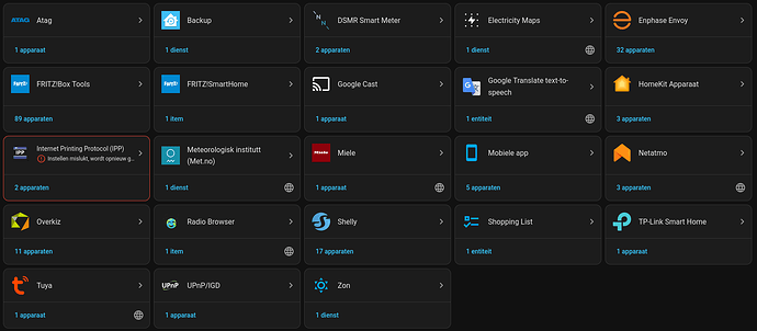

I have a core installation, of which support ends this year. So I installed haos on an other machine and started a restore as onboarding. The restore start was yesterday morning. The backup file is 258 MB with these integrations:
How much longer could the restore take on a i5-7500?
Or what is the best place to look what causes the restore not to finish?
