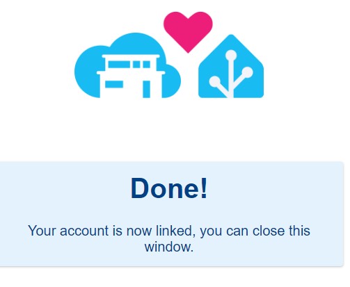

I click OK and it immediately takes me to the Nabu Casa site with this message:

Not sure why it takes me to Nabu Casa but if that’s not the right place it would explain why it’s not authorized. I did receive a notice from Microsoft telling me Home Assistant has been granted permission.

The Microsoft approval notice means consent was granted, but the return to Nabu Casa suggests the OAuth callback isn’t reaching HA. The OneDrive flow likely needs a fresh authorization attempt.
