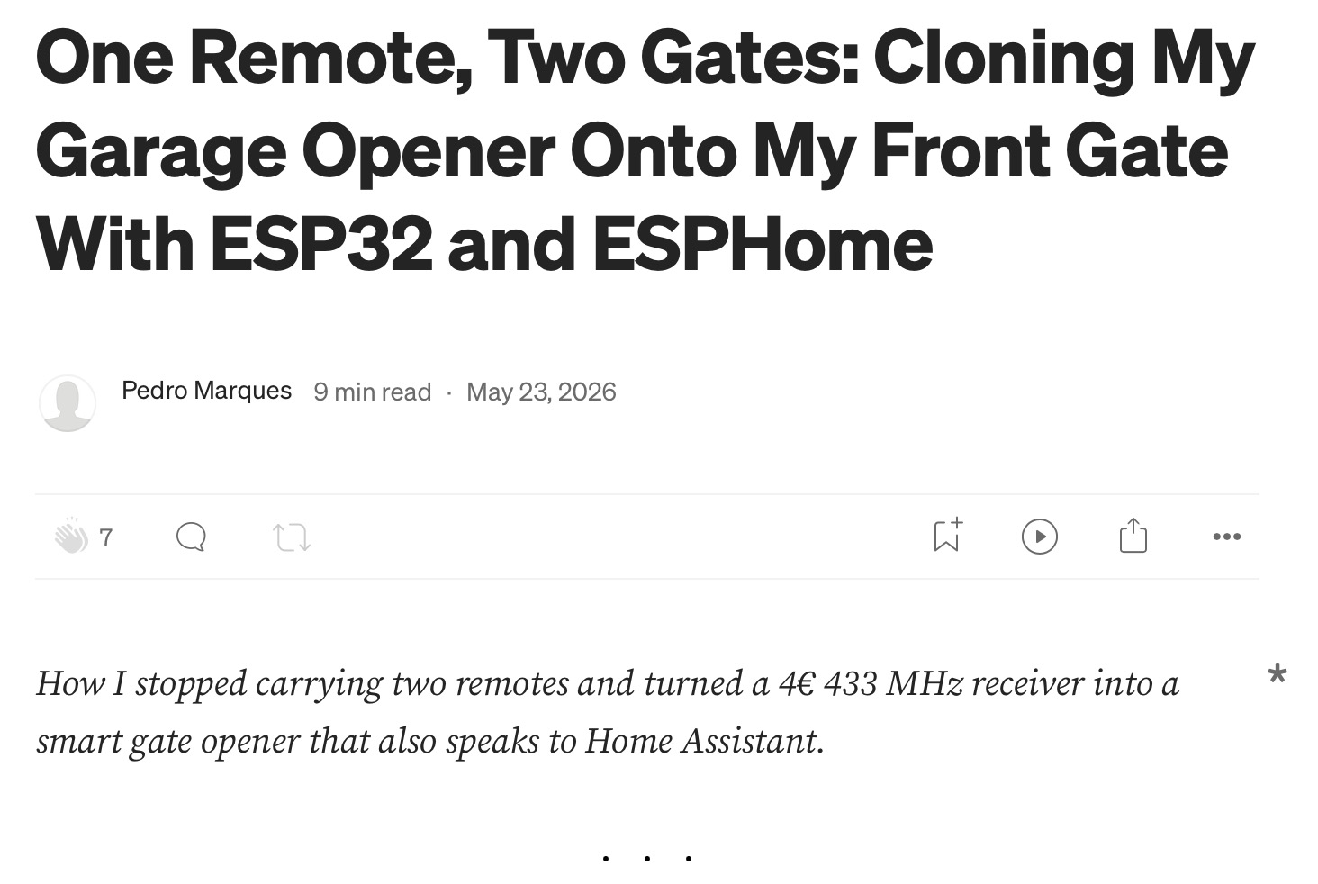

One Remote, Two Gates: Cloning My Garage Opener Onto My Front Gate With ESP32 and ESPHome
My garage remote has four buttons and I only used three. Instead of carrying a key for the front pedestrian gate, I taught that lonely fourth button to open it — so now a single remote handles both entrances, and the gate is also fully controllable from Home Assistant.
