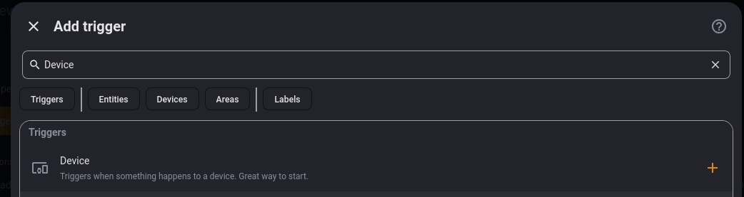

No, but some devices may now provide event entities instead of button entities.
Some things to try:
  1. Check the Device summary for each of you devices to see if they now include event entities. If they do, you can use the “Event Received” trigger. ZHA hasn’t fully incorporated event entities yet, so this likely won’t be an option for you.
  2. If your device has neither event nor button entities, you can try using a Device trigger (as shown in the linked thread).
  3. Finally, if the Device trigger does not list any of the desired trigger events, then you may have to go old-school and use a Manual Event trigger.

Did you check the device summary for event or button entities…?
Did you try a Device trigger…?
Thank you so much! When I type Device and select my remotes i see all the triggers like “turn on oressed”. You made my day!
