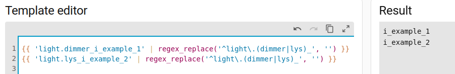

OK, I have one small problem still, more of a “housekeeping” thing. In two of the rooms there are no dimmers, but regular on/off lights. They are not named light.dimmer, but light.lys (“light” in Norwegian). I would guess it possible (and probably simple to ad an action that changes part of the variable iden so light becomes dimmer. That way I don’t have to create a separate automation for those two lights. I have tried to search for that, but I haven’t found out how to do a replace in a variable.
You’re welcome! Glad to hear to it works now.
Please consider marking my post above with the Solution tag. At bare minimum, the example demonstrates that choose is not always required to make decisions in the actions section. The Solution tag will automatically place a check-mark next to the topic’s title which indicates to other users that this topic was solved. It also helps others find answers to similar problems.
I suggest you change the template for iden to this:
    variables:
      iden: "{{ trigger.entity_id | regex_replace('^light\.(dimmer|lys)_', '') }}"
Proof that it works:
