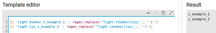

    variables:
      iden: "{{ trigger.entity_id | regex_replace('^light\.(dimmer|lys)_', '') }}"
      mode: "{{ trigger.to_state.state | bool }}"
But it won’t save. Probably because I have done something wrong. It says. Error parsing YAML: unknown escape sequence (linje: 20, kolonne: 59)
What is line 20 in the automation’s YAML code?
It’s the iden variable template. The only thing I changed.

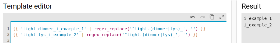

Hmm, it doesn’t like the backslash within the regex pattern (even though it works in the Template Editor).
Remove the backslash. The template still works properly without it.
    variables:
      iden: "{{ trigger.entity_id | regex_replace('^light.(dimmer|lys)_', '') }}"
