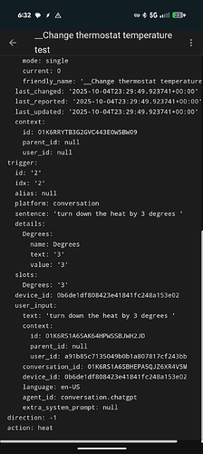

I used ‘Assist’ and typed in an instruction “turn down the heat by 3 degrees”. It’s throwing an error that appears to be related to the 3 being a string.
Here are screenshots of the travel data.

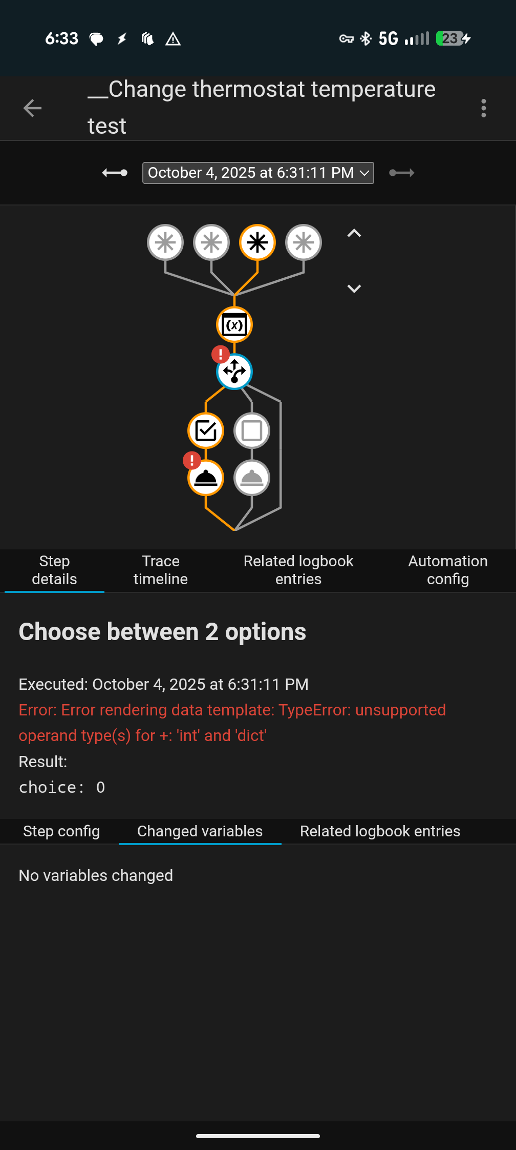

    adjustment: "{{ direction * trigger.slots.Degrees|int(0) }}"
It looks like a copy/paste error doubled adjustment, so instead of the integer 3 it’s getting a dictionary: adjustment: 3.
variables:
  target: climate.t6_pro_z_wave_programmable_thermostat

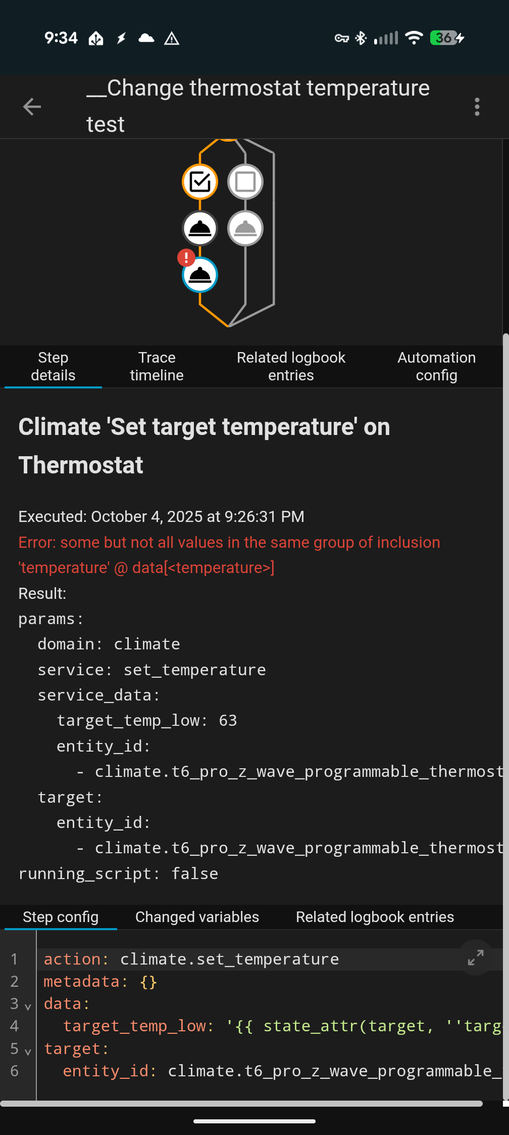

Thanks that resolved that error. Now I’m getting a different error and I have no idea what it means or where to find info on what it means.
Error: some but not all values in the same group of inclusion ‘temperature’ @ data[]
This is a screenshot of the trace info.

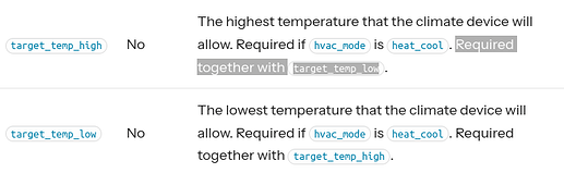

That’s down to my unfamiliarity with heat/cool… it looks like you always need to supply both target_temp_low and target_temp_high.
