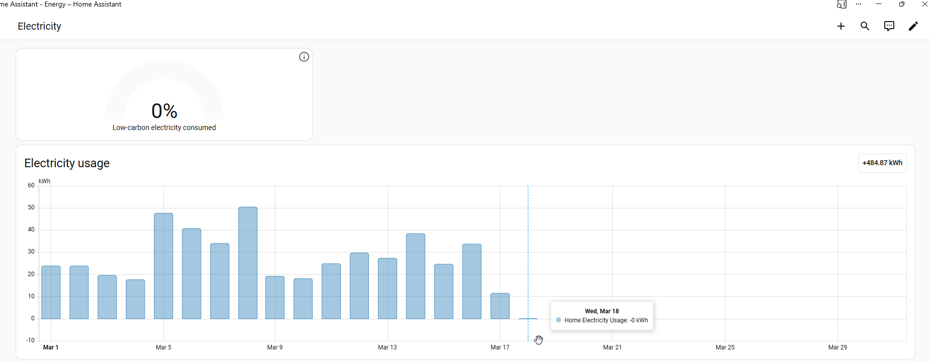

I’ve successfully implemented initial data dump via green button using github repo:
Other things I’ve done:
Installed integration ‘Folder Watcher’ and ‘Pyscript Python scripting’
What’s this for:
When i drop a new GreenButton.XML file in a predefined folder, the file watcher will trigger an event ‘completed’ and a python script will automatically call a service to take the new electricity data and move the new file to /Done folder.

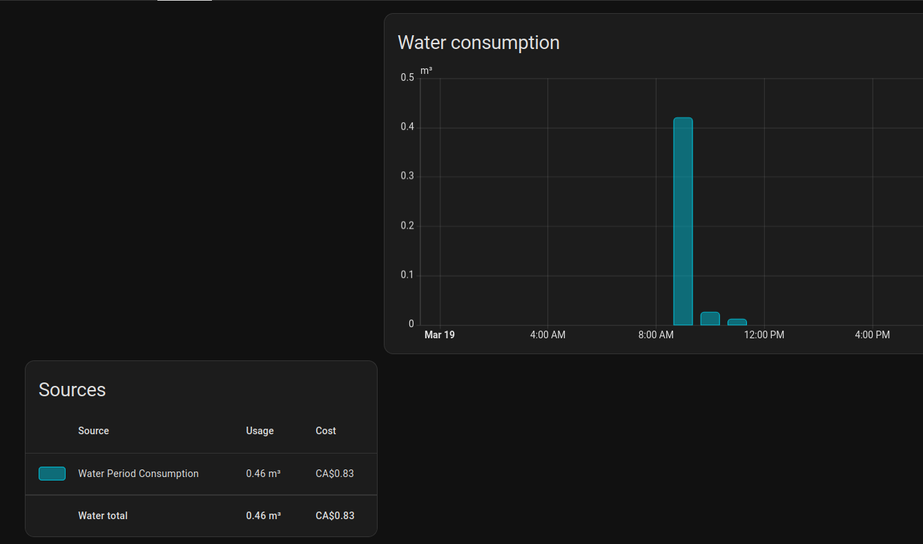

I was also able to get the neptune water meter hooked up trivially, and it emits data every minute or so! Hooked that up to also apply the tiered usage rates from the city, and it is working quite well:
Unfortunately the same receiver can’t listen to both at the same time, oh well. I ordered a second antenna so that I can listen to both simultaneously, probably overkill as you could do a time sharing system to listen for power data, but it transmits so infrequently i don’t want to miss it.
I actually just had an AI hook all of this up btw, i didn’t touch anything. But for anyone willing to invest in the hardware, pulling the radio works great for these two.
