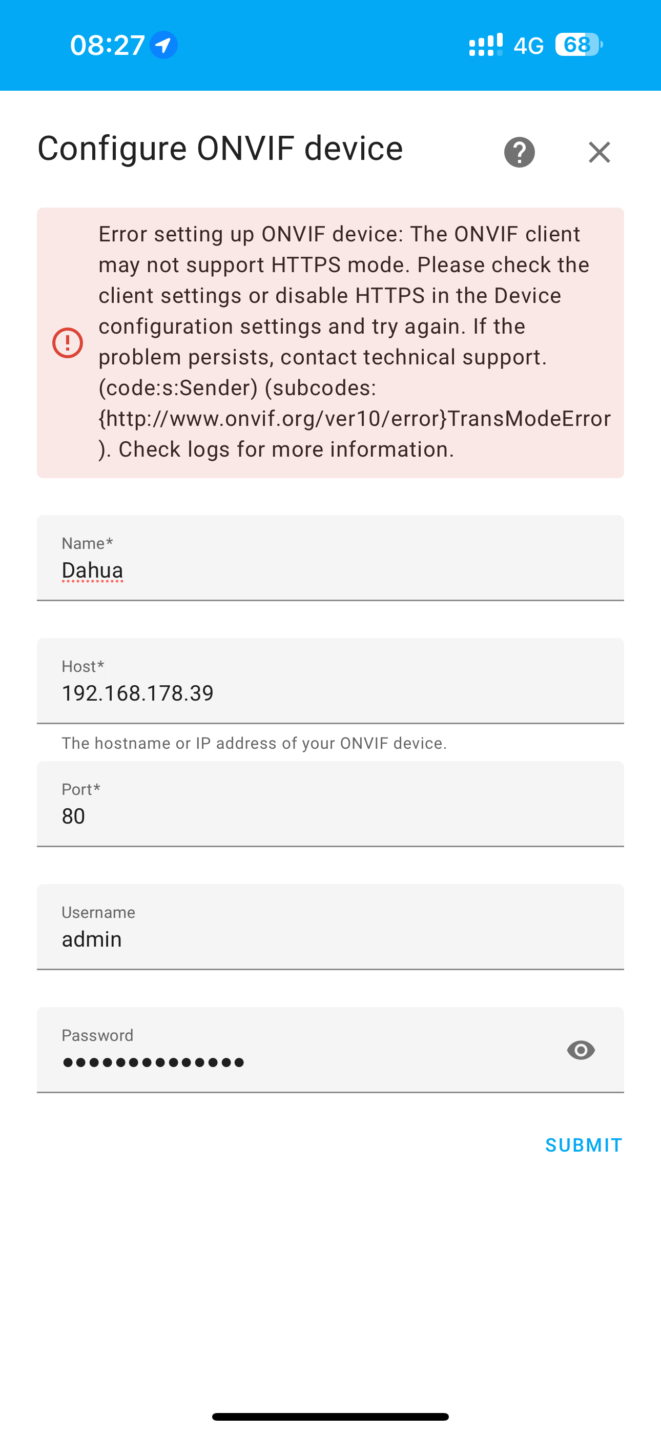

Hello, I am trying to setup this ONVIF but am met with the attached error. There is no means to disable from the configuration as the installer fails. How do I fix this? Thank you.
By device, it means the camera itself. When you go to the cameras ip, does it show as https? If yes try port 443 instead of 80.
