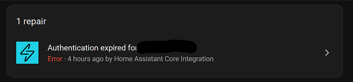

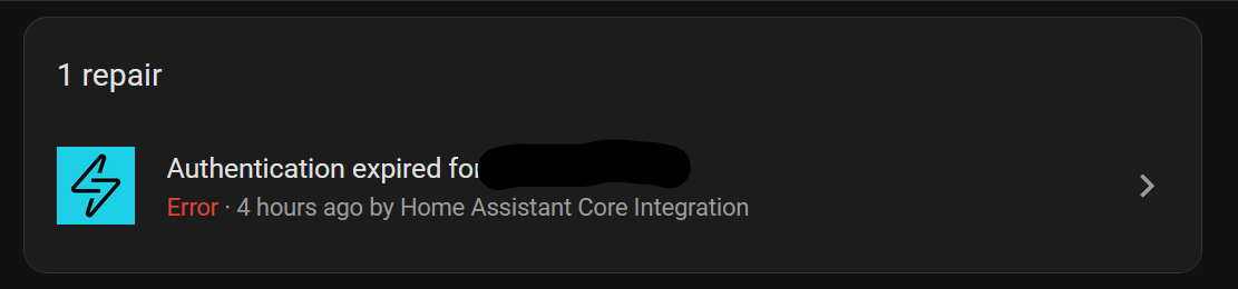

When updating HA today, I received one repair ; ‘Authentication expired for’ [my name] on Tibber;

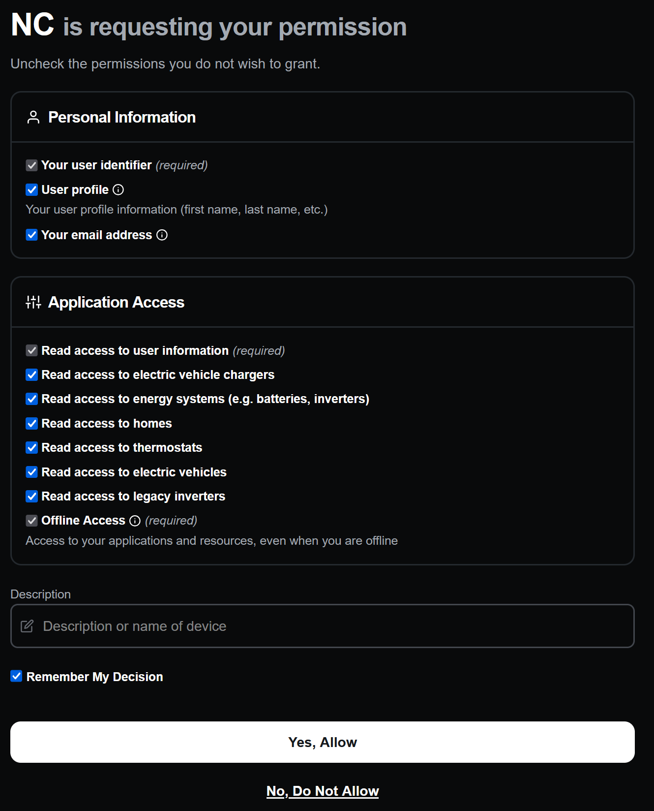

Then I’m redirected to ‘thewall.tibber.com/consent’ and I click;
Yes, Allow, afterwards I get;

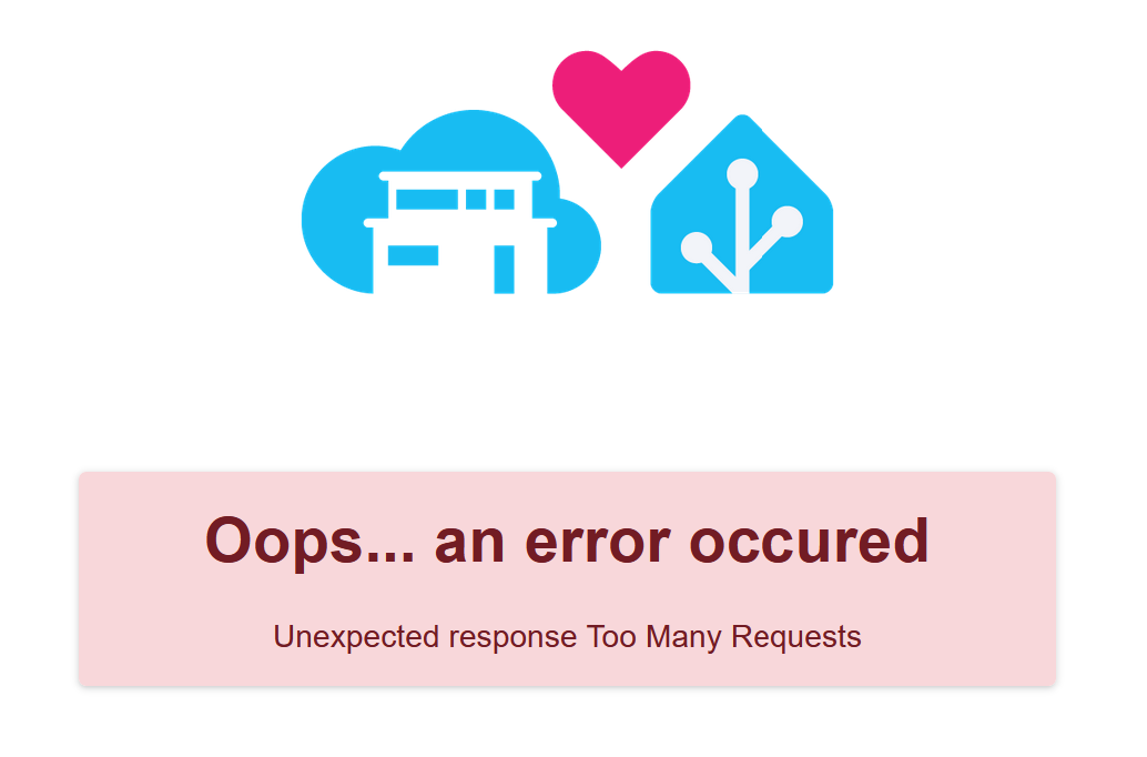

Oops… an error occured
Unexpected response Too Many Requests
Only special thing I have; I have two adresses in Tibber…

I don’t like depending on the cloud, I followed the steps, and rebooted HA, this is what it ends up with;
It is really beyond my logic why I’m depending on Nabu Casa rate limits. I don’t want Nabu Case, I don’t want to depend on the cloud. Thats the whole reason I’m using Home Assistant.

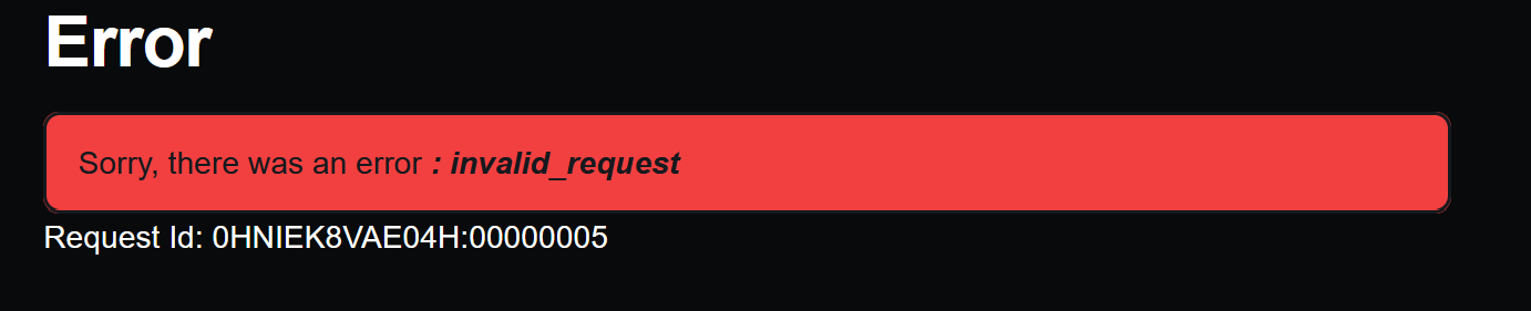

Hi, I also have the problem. Tried the Client ID and client secret (Tibber Data API) but it gives the error that @Lectere also have:

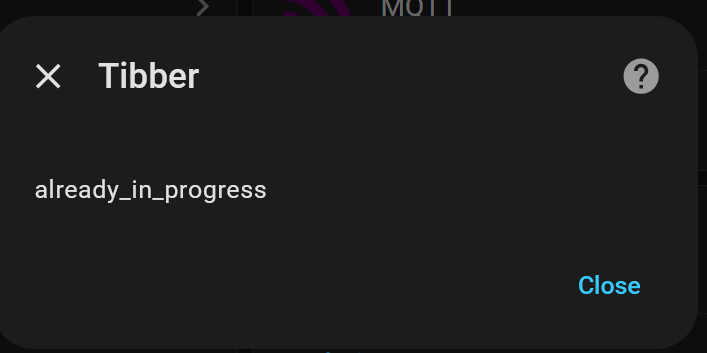

I created a new account, copied the two codes, deleted the Tibber integration, restarted HA. When I try to add the Tibber integration again, I have to paste the authorization code and after that I ‘have’ to open the same webpage again. Nowhere a possibility to enter the new credentials. Am I missing something here? Would be nice to get it to work again.

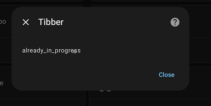

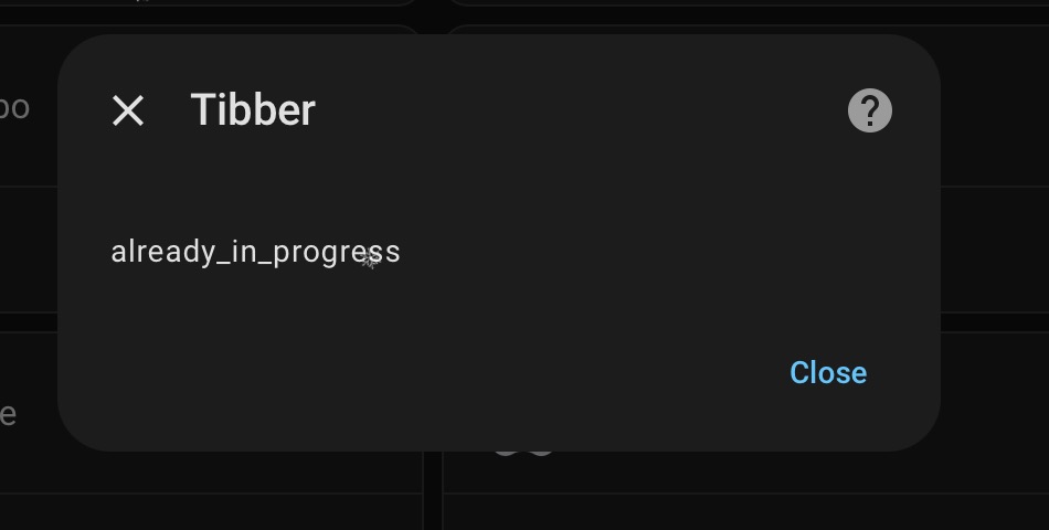

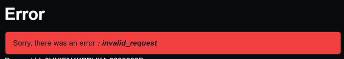

I made it to the part where I could put in my credentials and ID / Secret. When adding the Tibber integration , I now get the following message:
I managed to use the workaround, i removed Tibber, and then followed Tibber - Home Assistant,

Homeassistant is ratelimited by Tibber, until Tibber fix that you need to add your own client id and secret: Tibber - Home Assistant

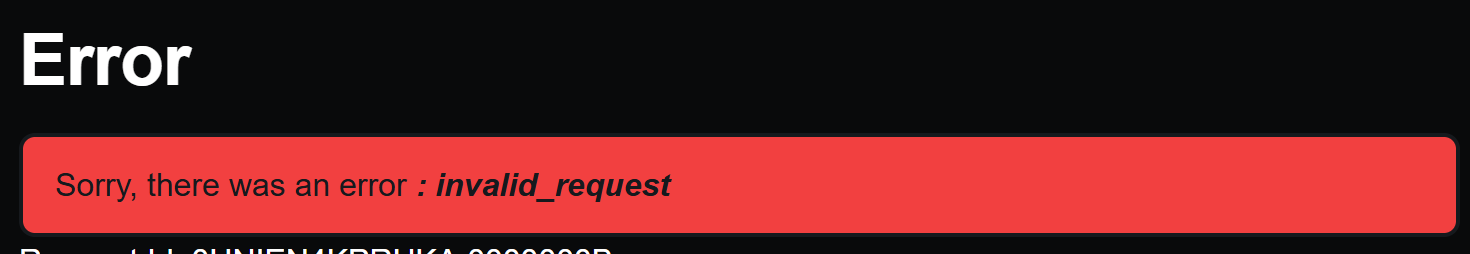

Thank you! I tried that but I get " Error Sorry, there was an error : invalid_request Request Id: 0HNIEN4KPSU5E:00000005". I think its the callback URL. I use duckdns. How exactly should this callback URL look like?
