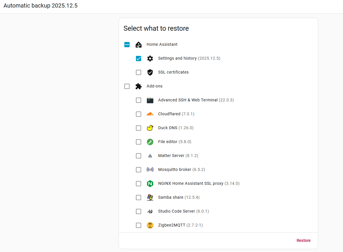

/Settings/System/Backups, Choose first-Auto-backups, then Choose 2025.12.5, then Tick what, if it’s only for Tibber-issue Tick, Homeassistant, and settings&history
Then click Restore
So only this needs to be clicked or?
The rest of the system will be as it was before the upgrade to 2026.1 but the changes made in 2026.1 will naturally have to be redone if I understand it correctly.
Short answer No, However the 2 ticks will restore CORE, and other “Settings” related
As the “Main” reason of this particular Update is CORE-changes, and not in any off your Add-Ons, or your SSL-certificate there is no reasons to restore these, if some of your Add-Ons also somehow failed, after latest CORE-Update, it’s caused by either CORE, or that these is Add-Ons is not “Updated” yet to “adapt” to changes made in the CORE, so there is no point in restore them, because they are not Updated ( unless you Updated them )
Yes ( and if you Updated any of Your Add-Ons )
NOTE: You will have to “Fix” Tibber and maybe some other Credentials again thou, but it’s a “Quick-Fix” , Just do it through the Fix-Repair Dashboards, it should be “smooth”
