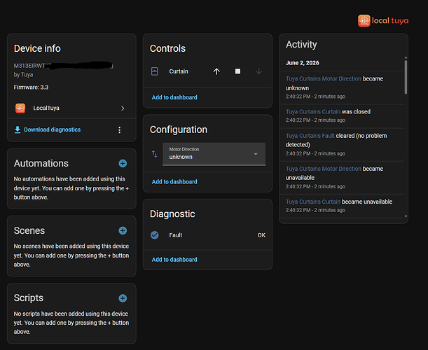

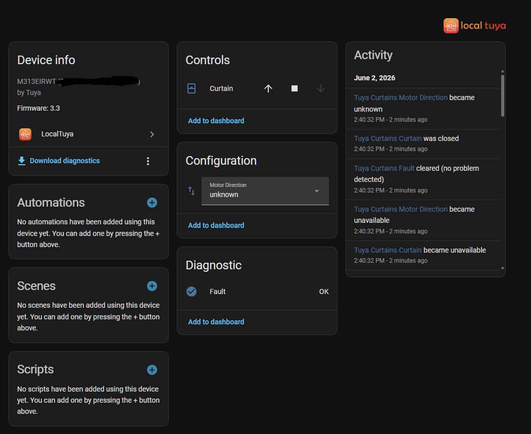

is there any way to flip the direction of bar so that it's the same as when I look at the curtain in real life
the entity has a motor direction but it does not work. Whatever you set it to it will flip back to unknown and it does not seem to have any effect on the actual curtain
A couple of things are tangled together here.
First, the root of the disagreement: you're running the same physical motor through two integrations, and each one interprets the position datapoint its own way (one treats 100 as open, the other as closed). Long term I'd pick one integration to control it, since two will also fight over state and commands. What you're seeing is a display/inversion thing, not the motor behaving two different ways.
On the Motor Direction reverting to "unknown" and doing nothing: that's a datapoint-mapping problem. The direction DP LocalTuya exposes isn't actually being reported or accepted by your motor (either mapped to the wrong DP, or this motor only accepts a direction change through its app calibration, not as a live-writable DP). Since it never echoes a value back, HA shows "unknown" and your writes have no effect. So don't rely on that control, set the direction in the app / re-run calibration or just correct it in software.
