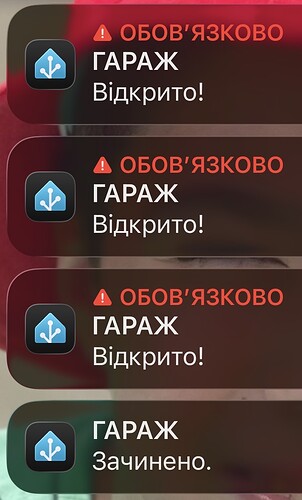

I have SNZB-04P sensor installed via Zigbee2mqtt. Everything works fine and home assistant sees it’s OPEN\CLOSED states without problems.
Decided to make an automation to get Push Notification’s and everything got messed up :joy:
When door is opened I get two notifications in a row - Door Closed + Door Opened
When door is closed I get two notifications in a row - Door Closed + Door Closed
What am I doing wrong? :grinning:

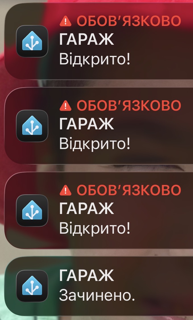

Tried Your code and even vibe coded with Claude one more alternative automation - still get two messages on open (Open+Open) and two on close (Close+Open) :slight_smile:
One more sensor reports correct. Could it be sensor malfunction? Is it possible to reset device or to reupload firware?
Where to dig more?
