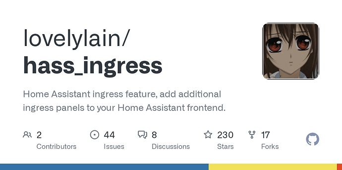

There is a third option, which is to utilize HA’s ingress support. I haven’t used this yet, but this integration should do the trick:
(Edited with correct link)
Thanks, but sadly this addon gives me same error: can’t load iframe which points to http, only https allowed.
My apologies, I linked the wrong integration. This is the correct one, and I’ll edit my previous post:
Yeah, second addon works, great! After installation i added this to my config:

I expect that it can be set up to handle the connection so that the dashboard can be shown without VPN as well, since that what the native ingress feature does in HAOS for addons.
But as I mentioned, I haven’t used it (yet, but am planning to) so I’m not sure what has to be changed to get that functionality. If I figure it out I’ll reply back.
Update: new day, new testings…
Success! I changed “work_mode” to “ingress” and “ui_mode” to “normal”. With my first settings (above) clicking on link caused web page to go “out of HA” interface and directly to set IP (replaced HA page, thus “replace” mode), and that’s why it didn’t work out of home network. Normal mode shows page inside HA dashboard, so it works everywhere.
