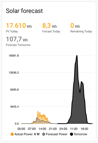

I got it working. There were several entities on my solar edge integration disabled by default. Also the sensor.solaredge_energy_today entity. I enabled it and used it. Now it works, but I’m missing the vertical Now line form your example. What code should I add?
Is there also a way to change the current Wh to kWh in the Apex chart?
Current view:
Your example:

Would you mind sharing the APEX card code for this one?
So the green line is the actual and the yellow is the prediction today and the grey is the prediction tomorrow.
  • Why do I see a Monday with 22 kWh, this one is not showing in the graph right?
Currently I have the version of @rany working without the Now line nut everything is showing in Wh instead of kWh, do I need to change something for your APEX card to get it working in kWh?
