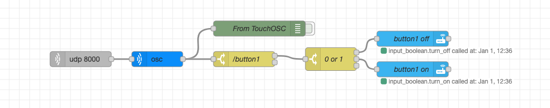

I’ve created a simple flow that controls a toggle helper in Home Assistant. The flow listens on UDP port 8000, confirms the OSC address, switches on the payload value, and finally triggers an action in HA.
Th OSC message from TouchOSC is /button1 with an integer parameter of 0 or 1, for ‘off’ or ‘on’.
