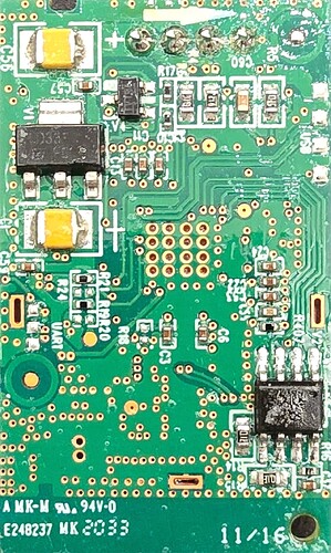

@gekkehenkie11, I’d like to thank you for the firmware update instructions you posted on June 4th!
I have the same GRJWB04-J wifi module in my air conditioner. It came with firmware version 1.23. I recently updated it to 1.31 (via the app) since that version finally makes it possible to silence the beeper (older version have a bug that silences the beeper only every other command). Unfortunately I did not realize in advance that firmware 1.31 comes with a different cloud protocol that requires Internet access. Without Internet access, local access (Home Assistant) stops working after just a few minutes.
This is not new. The old firmware had that as well, but it’s fairly easy to circumvent that by setting up a dummy server, and that’s exactly what I had been using. This workaround no longer works with the new cloud protocol (more info).
It’s not possible to downgrade via the app or forged firmware update requests. However, I was able to downgrade via the debug UART. The ATWO command by itself was not sufficient. It works fine for upgrading to a newer version, but downgrading always returns to the same version after the reboot. However, executing the ATSC (Clear OTA signature) command did the trick. After that the downgrade with command ATWO went just fine.
So, I’m back on firmware 1.23, with Internet access blocked. I’m happy. Sure, the beeping is back, but for now I’ll live with that. I had been thinking about removing the beeper from the PCB, but I think I’ll go with your ESP replacement in the future.

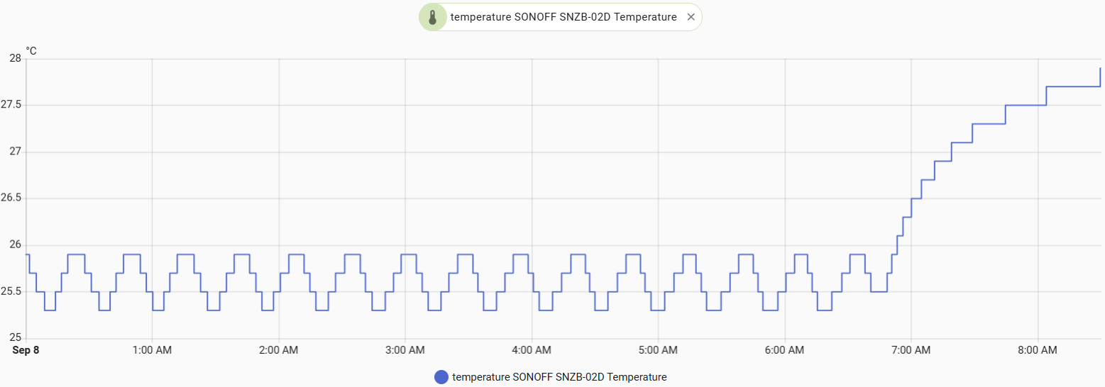

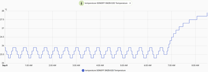

Hahaaa use this project, my friend! It’s actually the main reason I’m now replacing my original modules that I have with the ESP ones. I’ve bought an external temp sensor that’s about 0.2C precise (actually I bought 3 types, but I like this one currently most: https://www.amazon.com/dp/B0C27TLFV1 ) and am now using that as input to my custom AC temp regulation algo, LOL.
It’s actually still super simple, what I do is I us an HA automation to switch the AC to “fan only” once the temp is too low and then switch to ‘cool’ when it’s too high (with a target temp slightly below my real target temp), but I’m still experimenting with the exact values that I like best. But you can also for example make custom cooling strategies, if you want certain parts of your night rest cooler than the others for example. It’s frikking awesome LOL. And of course the beeper needs to be off. Actually I only just started experimenting with this and it already works very well, but I’m going to experiment with ever narrower ranges etc the coming days. But this was last night for example:
as you can see I kept the temp within an 0.5C degrees range, but of course you can even narrow it down, which I’m going to experiment with. You can also see that the target temp changed abit around 2:50AM, it’s when I woke up and felt I needed to lower the temp even a bit in the algo. Since it’s now way more precise than before, I’ll need to find the perfect target temp for me that I like best of course.
The internal AC cooling algo is WAY less precise, the AC I have cools down like 30 minutes, then switches to fan only for about 30 minutes etc (well, in practice ‘fan only’ but of course it’s still within the ‘cooling’ mode), but in the beginning/end of those time frames I always felt that the temp was too high/low. So that’s why I’m now making may custom cooling algos with HA.

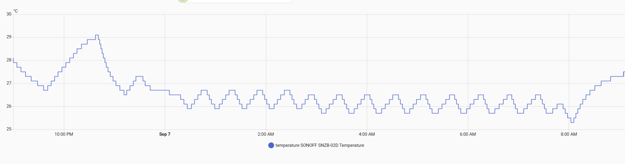

BTW, ran a new test with my custom cooling algo, the temp range is now even a bit smaller and I lowered the temp range a bit. Tonight I’m going to experiment with even a thighter range, cause I can still feel the difference between the AC cooling and not cooling, although it’s already WAY better than before (compared with the old situation, using the AC’s own cooling algo)
So if anyone would like to do what i’m doing above (custom cooling strategy) then don’t buy that damn sonoff temp sensor LOL. Last night it just got stuck at a certain temp. It did report to the zigbee network but somehow with a stuck value. So I’m now switching to the other sensor that I bought: Amazon.com: THIRDREALITY Zigbee Temperature and Humidity Sensor 2 Pack, Digital LCD Display, ZigBee Hub Required, App Records, Remote Monitoring and Smart Home Automation, AAA Batteries Included : Appliances which hasn’t been stuck (yet LOL) and seems equally accurate as the Sonoff. Going to see how that works. Either way, with an external temp sensor driving the AC via HA, I guess one should implement a watchdog automation to check, say every 20 minutes, and take over in case something doesn’t look right and then switch to have the AC take over the regulation again.
Anyway as a result I woke up thinking ‘hmm my room is cold’ LOL when it was actually 3 degrees C lower than what I wanted. The damn AC had been cooling really the whole night.

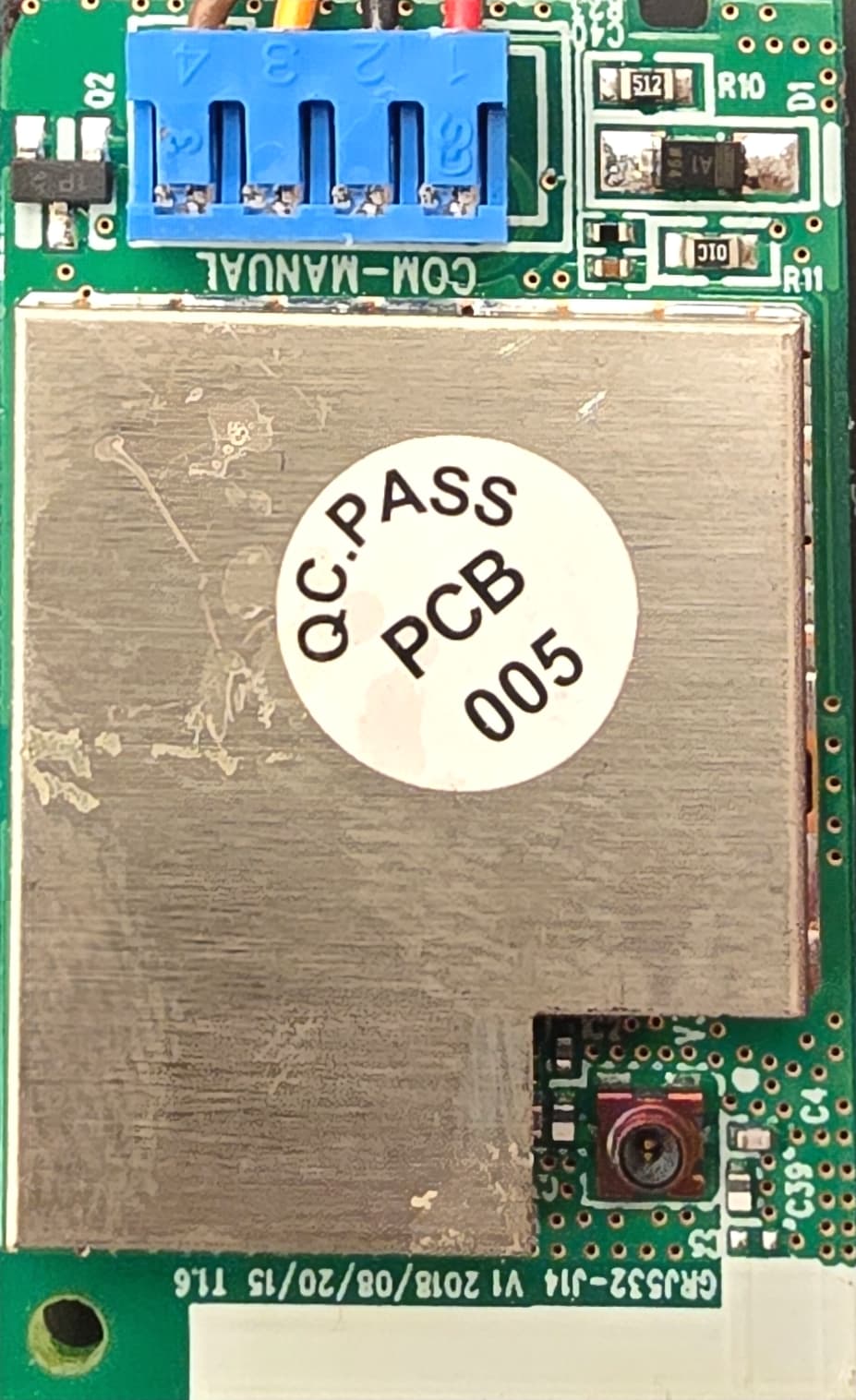

I had a 2nd unit installed last week and it has onboard wifi instead of a port to connect a wifi module. So I am unable to replace the wifi module.
Therefore a possibility of connecting a custom wifi module to the COM-MANUAL port (which my new unit also has) would also be very useful for me.
