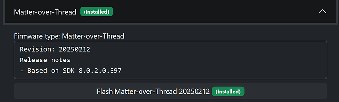

I am still quite new to home assistant. But since I have a technical background, I was able to solve my issues with the help of google and reading forum posts by myself in the past.
However, since yesterday I am running into issues I can’t figure out myself. I, on one hand updated home assistant/core to the latest versions and I added four Tado X thermostats to matter on the other hand. Since then I am constantly facing crashes of the Open Thread Border Router.
For the moment I can’t really figure out the root cause, since I changed more than one thing on the system. What I also observe is that the thermostats which are further away, every now and then become unavailable, probably due to weak signal strength. However, even if undesirable, I would not expect that this should be the root cause for the crashes. The add-on should be resilient against such behavior.
I have a lengthy log file, which might contribute to find the issue but I don’t see a possibility to attach it to this post.

Can you guys try to reflash SLZB with Matter-over-thread firmware version 20241105 ?
Okay, the situation is a little different for me. My OTBR was fine for several weeks, when I integrated my smart lock device. Later on I added two smart thermostats of different manufacturers for testing purposes, which still was fine for about two weeks.
And then HA update + a few more thermostats => OTBR crashing
Where do I get an older FW file? It only shows me the latest, which is also installed:

I’ll try to figure out where to get the older FW version

Update:
Since updating the SLZB-MR3 to Version 3.1.3 last week the OTBR is running without crashes since more than 3 days. Seems that the FW update solved the issue.
