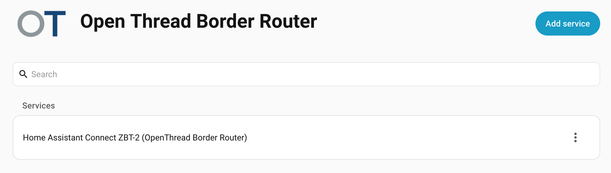

I tried to remove and re-add the Open Thread Border router integration because it was broken. I was able to remove it successfully, but when I tried to re-add it, it is asking me for a HTTP URL. I searched, but was not able to find the IP address of the ZBT-2.

To answer my own question, the integration does appear to be the driver. I went into the device and re-selected the thread integration, then deleted the app and reinstalled it. I had to pick a serial port for the app, but fortunately, one of the serial ports was ..../Nabu_Casa_ZBT-2_.... so that wasn’t too hard.
The app was installed, and it installed the driver (aka integration) and configured it properly. The integration is now green.
