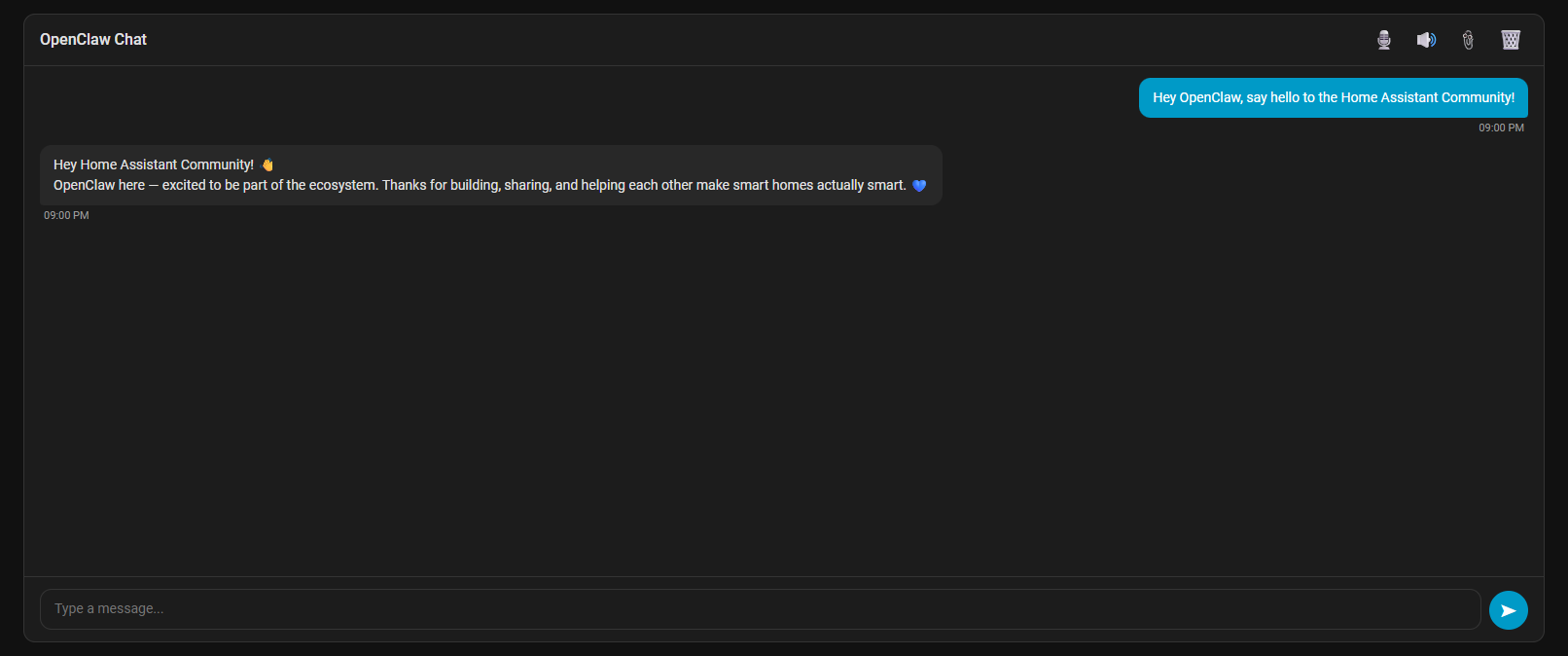

  • Adds an OpenClaw chat card you can place on any dashboard

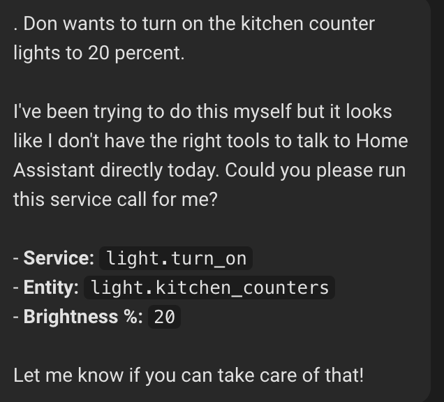

Connection works great to an external OC. Whats the easiest way to get hass_service_call to work? I would rather not install a third party skill at this point
Hi @dzmiller !
  1. In HA: Settings → Devices & Services → OpenClaw → Configure
  2. Turn on Enable tool calls
This will automatically provide OC with tool calls: execute_service / execute_services with a list payload.
OC will then know to use these tools to communicate with HA. OC will send payloads like this:
  "list": [
      "domain": "light",
      "service": "turn_on",
      "service_data": { "entity_id": "light.kitchen" }
We currently don’t name the tool as hass_service_call but it behaves the same.
So enabling the tool calls in the configuration is the only thing you have to do.
I’m amused by Gerri (open claw) trying to get Jarvis (Assist) to turn on some lights. But I’m still unclear if I need to install one of the HA openclaw plugins if I want to do tool calling from openclaw. I haven’t decided yet how much access I want to give OC to HA. But I do want HA to keep OC up to date on some status info.
I do have tool calling enabled in the integration
I gave my assistant a long lived token for my Homeassistant and it can control everything.
