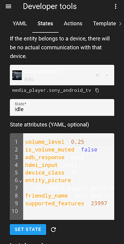

Does the media player pull in an image in HA. For example, the ADB Android integration does but the Android TV Remote integration doesn’t. In dev tools states at the top it shows the below for entity picture and uses and API token. I’m wondering if a long lives access token would work. when I paste in the below in a browser using http://192.168.0.x:8123/ with the the IP being my HA server I’ve been moving to ESPHome/LVGL but I’m pretty sure OpenHasp can show web URL images. Below is from Spotify with the API and cache values removed.
You could also use the generic camera integration to use the URL as the source but I don’t know if the cache and ApI token will change randomly or not. You may be able to control the update interval this way also.
EDIT: cache isn’t needed
entity_picture: >-
/api/media_player_proxy/media_player.sony_android_tv?token=apitoken&cache=random_number

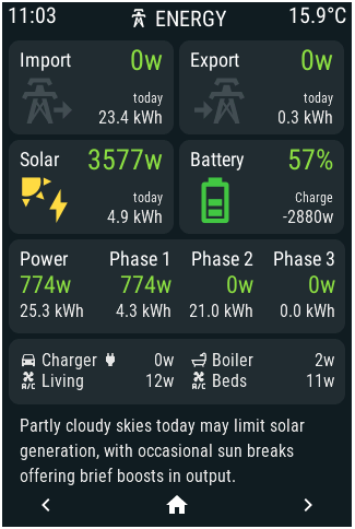

I’ve got a page showing electricity usage that includes yesterday’s energy and cost. It also displays the rates. Now these are pretty static, so on a reboot of the display they can take ages to get the values displayed. I’m running a Guition 4848S040 with a battery, but annoyingly when I unplug the charger, it always reboots!
Is there any way of forcing the data through, other than a reload of the openhasp integration?

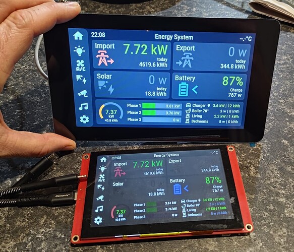

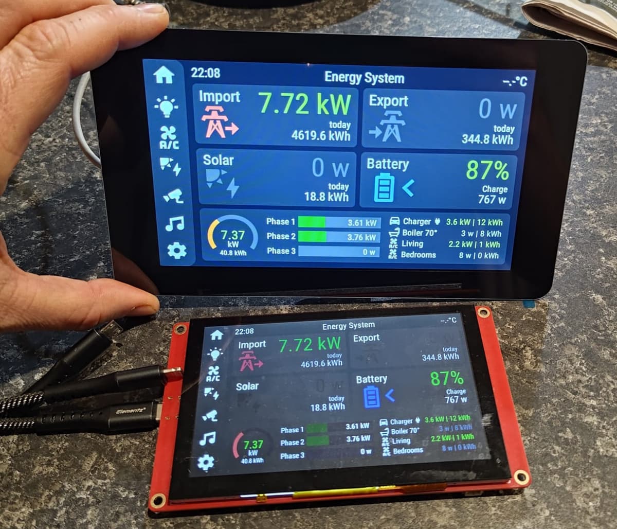

I’m loving the Waveshare 7" touchschreen as a controller that isn’t a tablet!
hallo nice can you share this code or weather ?
