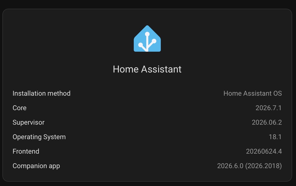

I have started receiving the following message repeating in my raw core log. I just started noticing after the most recent upgrade.
