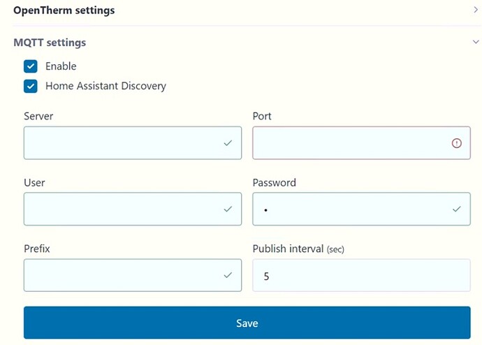

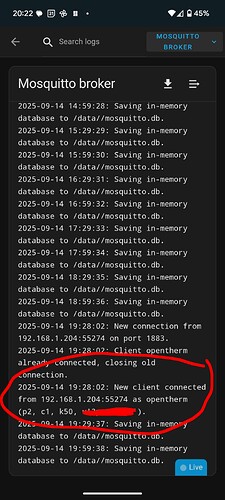

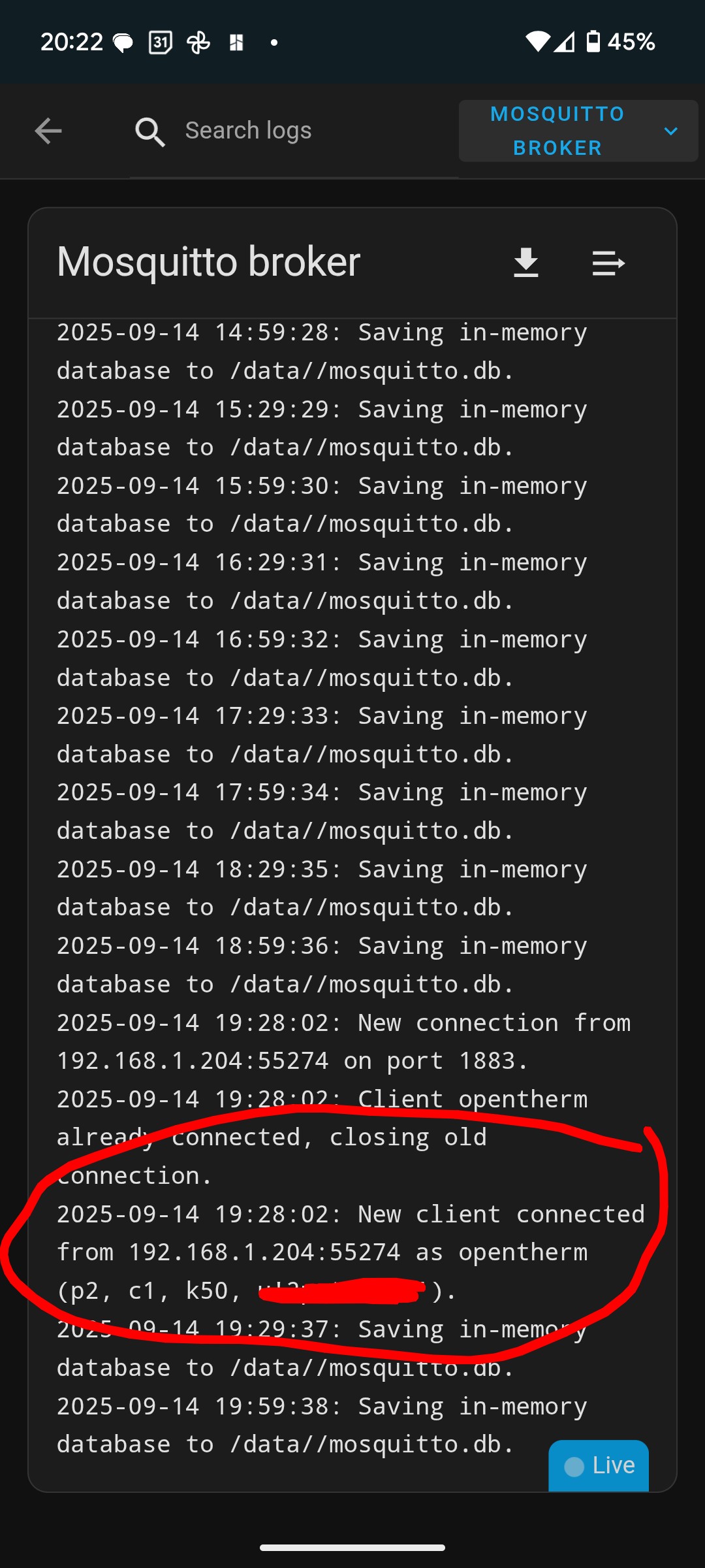

Hi, for some reason MQTT says it is connected but is not being detected in HA. I can only embed one image but both HA and otgw suggest connected to MQTT. OTGW has the Home Assistant Discovery box ticked. Latest firmware Anyone have any ideas?
Chris
Try rebooting the ESP from the web interface. If this does not help, show a screenshot from mqtt explorer, for example homeassistant/climate
Yeah it was just me being lame and not setting up Mosquitto properly. #timewaster.
