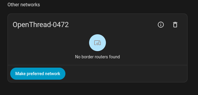

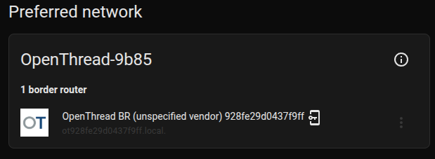

Hey @JBS - I was able to start the OTRB container as well and it connected well via the REST API with my Home Assistant but somehow the border router is not displayed under the Thread integration.
Were you able to get this done as well?

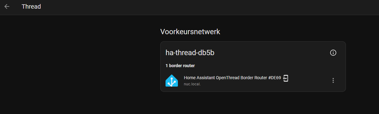

@erickubenka Yes, I do see my Border Router in HA using the Thread integration:
The Thread Border Router Integration is needed as well, did you install that one as well?

Oh yeah, I am using the OTBR and Thread integrations. The network itself is displayed after I followed this setup guide here to create a dataset and bring it active.
https://openthread.io/guides/border-router/form-network?hl=de
But the border router itself is not displayed, it just shows the network.
