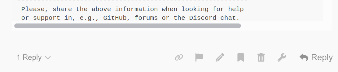

Hello @Sir_Goodenough ,
Unfortunately I don’t see a “solution checkbox” when I click the three dots on any of the posts. This is what I see:

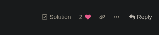

This is what you are looking for.
You might need to post a bit more before it shows up as a new poster.
