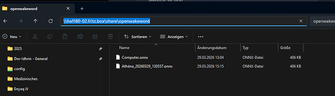

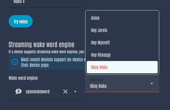

I have uploaded 2 onnx-Files to \share\openwakeword and restart HA but they just dont show up in the list of wakewords.
The documentation says at one point I need tflite-Files, but where to get them from? openwakeword.com only generates thos onnx files… :frowning:
Ok, found the download for tflite files, restarted the OpenWakeWord App and now it is working.
