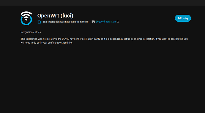

Hmm, that’s weird, because no devices show up in Home Assistant when I connect using luci:
According to the doc the devices should show up there, or is that not the case anymore?
