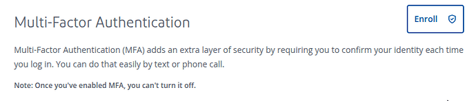

This part: Note: Once you’ve enabled MFA, you can’t turn it off.
… makes me abandon all hope. I have no plan to enable MFA (unless they prevent account access without MFA in the future)

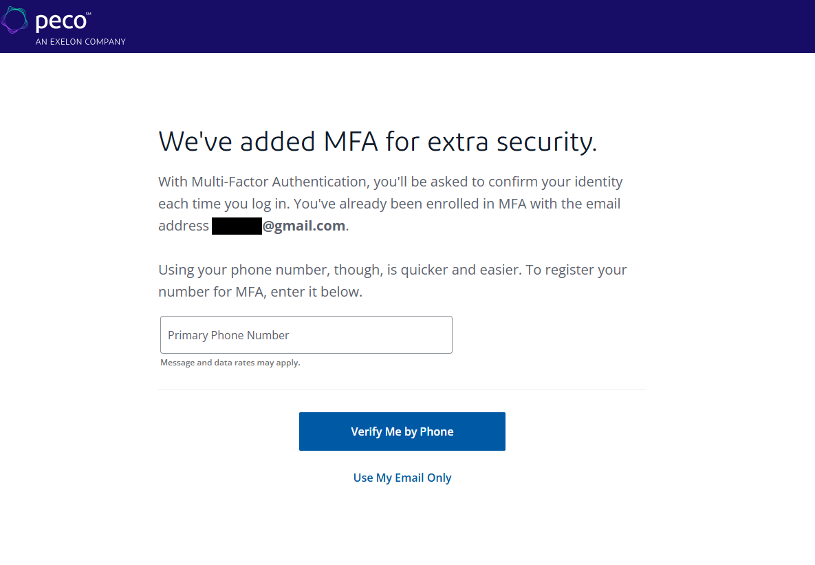

It’s official (as of August 7, 2025) PECO now requires MFA as part of the log in process, they no longer support simple Userid/password logins. This integration is now inoperative for PECO customers.

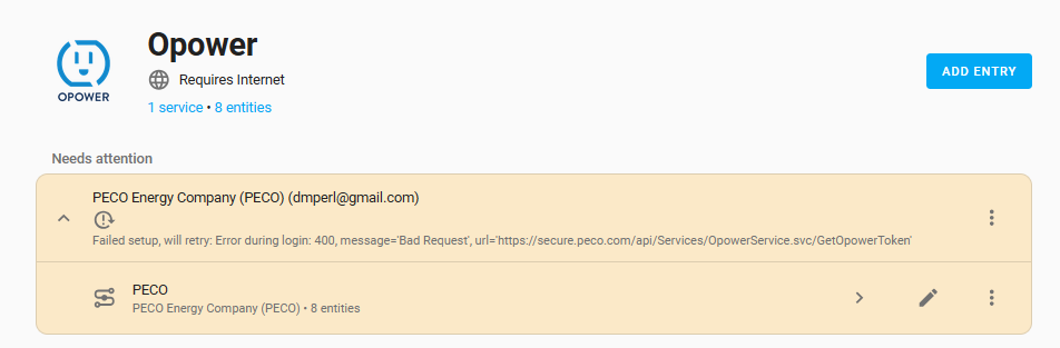

MFA has been added to the Opower PECO integration with 2025.9.4.

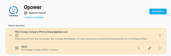

Edit: Eh, I guess there is an issue with restarting, the MFA token becoming invalid, and not being able to get a new one without deleting and reinstalling the integration. Probably better to keep this disabled (or uninstalled) for now.
Opower for PECO was my motivation for moving to 2025.9.4, but as you said the token does not “renew”.
I get this message: (I re-enabled just to get this message :wink: )
Failed setup, will retry: HTTP Error: 401 URL: https://peco.opower.com/ei/edge/apis/multi-account-v1/cws/peco/customers?offset=0&batchSize=100&addressFilter=? Status: 401 Response: {"error":"invalid token","error_description":"JWT expired at 2025-09-23T14:16:23Z. Current time: 2025-09-26T19:36:09Z, a difference of 278385035 milliseconds. Allowed clock skew: 1000 milliseconds."}
See: Opower integration with PECO Exelon broke with PECO MFA · Issue #150289 · home-assistant/core · GitHub
