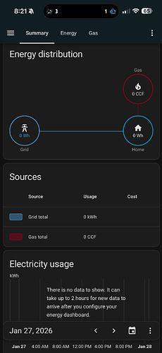

Is anyone getting data from PG&E? It’s been connected for 5 hours and no data.
The Power integration says Opower - Home Assistant.
Because utilities only release usage/cost data with a 48-hour delay, the integration inserts data into statistic objects. You can find the statistics in Developer Tools > Statistics and search for “opower”. This delay means that there will be no data in the energy dashboard for today and likely yesterday (depending on time of day you are checking).
