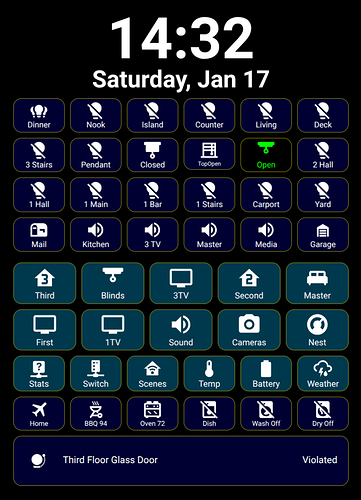

I personally like a dashboard that does everything – there is nothing in my home that I can’t monitor or control from a single dashboard. To make this manageable, I use buttons that open conditional cards containing vertical stacks, along with buttons to control the most frequently used controls. These are fast to load because all they do is change an input_boolean, and then a script fires the action based on the boolean. I have 16 of conditional cards and 30 buttons, along with time and date, in 1500 lines of code. It is my understanding that HA does not load the conditional pages immediately, but waits for them to be opened. I confirmed this by creating a dashboard without the conditionals and it loaded 0.03 seconds faster (I get a Largest Contentful Paint in about 1.3 seconds, which fell to ~1.27 when I removed the conditionals, which is so little difference that it must be just loading the code itself, not rendering anything). I also made a dashboard with the time and date and 12 buttons and nothing else, and it still took ~1 second to LCP, so I make it that the time cost of “do everything” vs “do very little” from the dashboard is 0.3 seconds, a cost I’m happy to pay.
On mobile, it takes about 3 seconds for the page to be responsive with a WiFi 5 connection. This is long enough to be annoying on occasion when you want to do something fast, like click skip on the opening credits or shut the garage door.

In the screenshot, the lighter background cards open conditionals, while the others are either action buttons or reveal a state, like the oven temperature.
I put this in another post, but most of the change occurred because my variation eliminated em sizing which shrank the font. Using smaller fonts added .6 seconds to loading!
