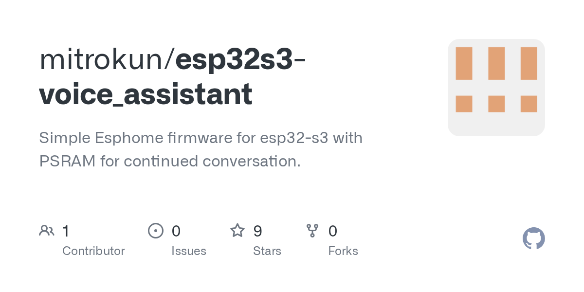

If you are ready to interfere with the VPE firmware, you can change the logic of the satellite.
Or just assemble a DIY project to try it out.
If you just want to start the listening stage in your automation, it will be enough to forward the voice_assistant.start action to HA (see this block). after that, you can use it in automations and scripts.
