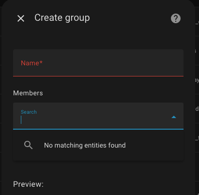

I was looking at adding a group for this, but the Notify group does not list anything for me to select, so my mobile devices must be a different domain?
Is there a way to make a mobile app group, or alternatively how do I get the actionable notification to work for multiple devices?

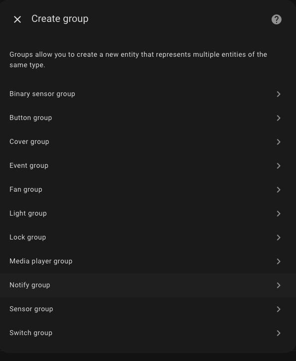

About the Notify groups, very interesting. I did not think to check the docs on that because the option is there in the UI to create a Notify group. I wonder why the option is included when it’s not supported?
So anyway, I created the notify group and I can see it in Developer Tools and tested the action there and found it to work.
However, I cannot figure out how to reconfigure my blueprint inputs now to accept this group as the device to notify. Should it be a device or entity selector, and which domain?

The option is supported… but there are currently 2 different methods for notifications. HA notifications are in a long-term overhaul process to make thing like what you are trying to easier and more in line with how other actions work.
Prior to last year, all notifier integrations used the method that the Mobile App is currently using. In that method the integrations create specific actions for each notification endpoint. This method is currently the only one that works for notifiers that have complex data.
Late last year the new method was introduced in which all integrations use a universal action, and supply specific entities that can be targeted by that action. So far, only integration that use just the message data variable can use this method. It is these notify entities that can be grouped using the Group Helper.
