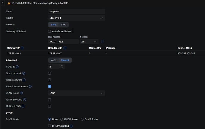

Thanks for posting the Unfi settings. I’ve set-up a “sunpower” network using the 172 subnet IP range but all I get is a “IP conflict detected. Please change gateway subnet IP.” error after wiring up to the port I set-up on the VLAN
Any ideas?

I recall IP conflicts before though I haven’t seen any in some time thus I could be miss-remembering, but occasionally Unifi dashboard would show both ports as having the same IP address. Eventually it would always sort itself out. Can’t imagine using a USB/LAN having any material impact. Have you tried changing the gateway IP? Any idea what device Unifi believes is already on 172.27.153.2?

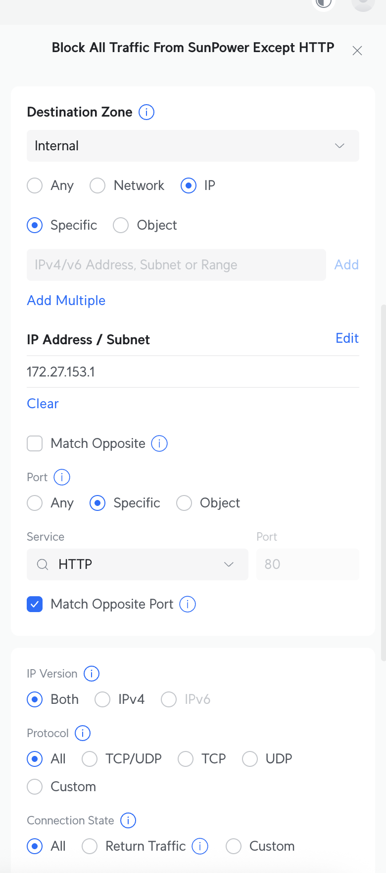

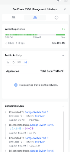

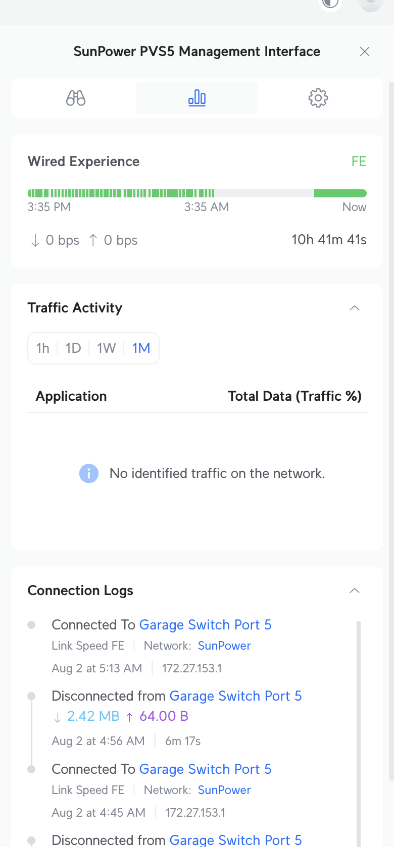

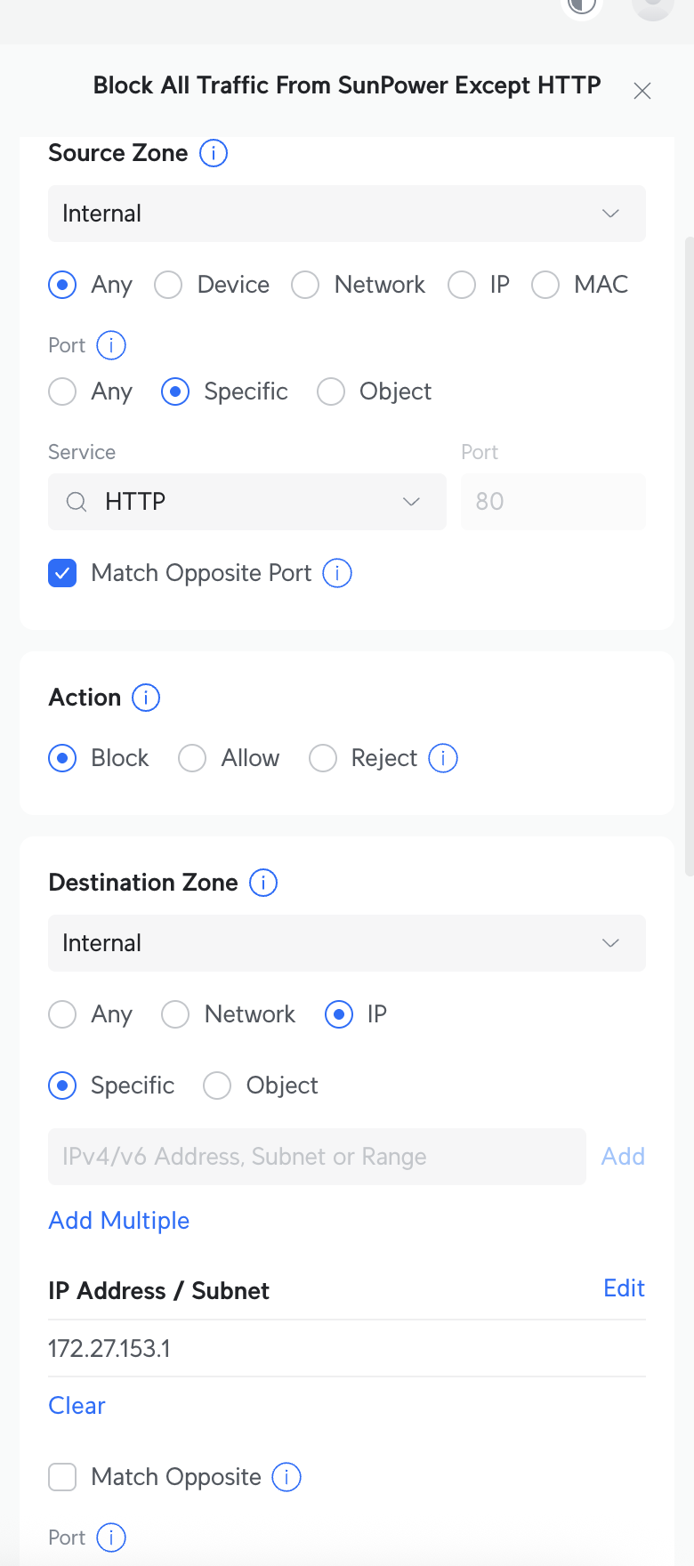

For anyone who followed my previous posts about using a VLAN w/ Unifi equipment the one issue I had was that periodically the integration would fail to connect. As documentation mentions these timeouts and it would eventually reconnect I kind of assumed it was just how my model behaved.
However, hitting the management interface directly seemed to work more often than not even if the integration was failing at the time. Also the Unifi dashboard would show the management port periodically connecting and disconnecting and I was curious as to why that would be case. Anyway perhaps the management interface port might be overwhelmed by other network traffic. Still a hypotheses but I created a firewall rule to block all traffic to management interface that wasn’t on port 80 and the disconnections have ceased. The wired experience clearly shows where the firewall rule was put in-place
Thanks for this, trying it myself with my PVS6
I’ll add that you need to make sure the new policy is at the top of your rules or it may not block anything. I have an extensive list of rules due to my IoT network so it took me some time to figure out why other traffic was making it through my port scan.
I suppose we could also make it so only your HA server has access with an additional rule
Agreed. I considered that but w/o security being a big concern I liked the flexibility of being able to connect to management interface via any computer on my network.
I’m curious to see if complete isolation helps. I honestly think they just introduced some bugs (features) with a firmware update.

I understand that the integration documentation hints at the behavior you’ve been experiencing. In my case, the only issue I’ve encountered was intermittent connectivity on my management port. Since implementing the firewall rule, my connectivity has been completely stable — not a single drop.
Unfortunately, I haven’t been able to capture the exact traffic that is being blocked to confirm precisely what resolved the issue. Like you, I only had the management port (and the router) natively on the VLAN. That said, there’s really nothing to lose by setting up a similar firewall rule to see if it resolves your problems as well.

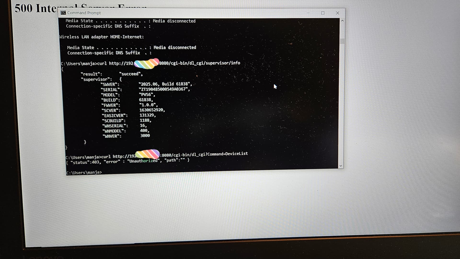

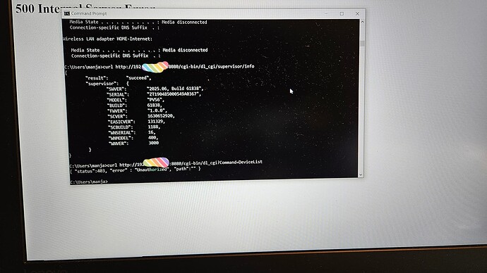

I am getting following messages. 192. IP address is Mango router IP address assigned on my local network. Can you please let me know how to fix it? I can’t see devicelist. BTW Mango router is in repeater mode, thats the only way I could connect router to my home network. I tried wired connection too but I get same messages. See attached pic.
Did you able to resolve this?
