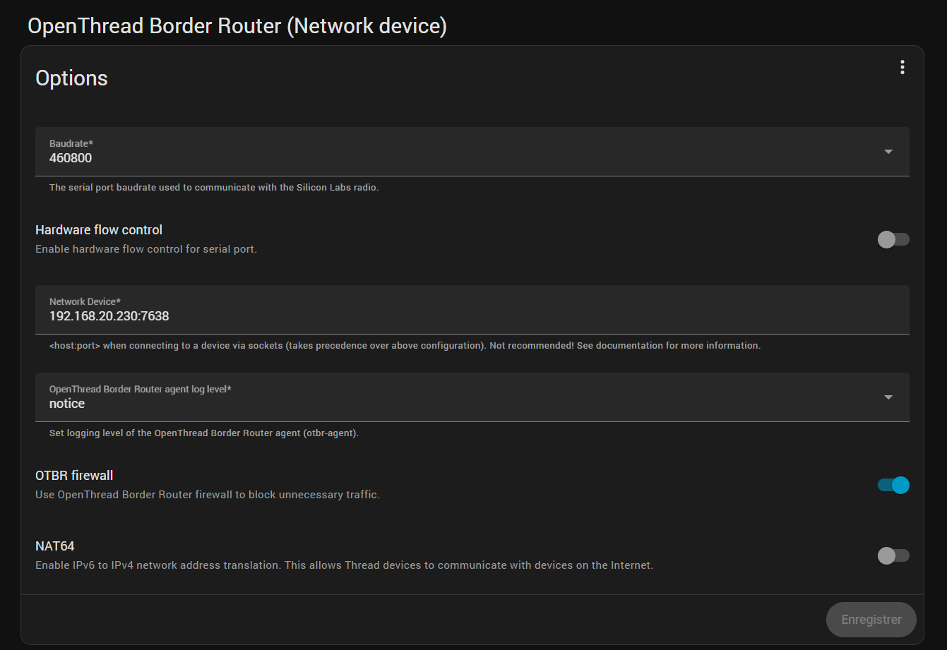

Here is my simple config.
If someone get an idea i would be gratefull. I already try to flash CC2674P10 firmware to the dev version (20250325) without success.
Solved when i use OBTR official add-ons instead of community OBTR network add-on :frowning:
