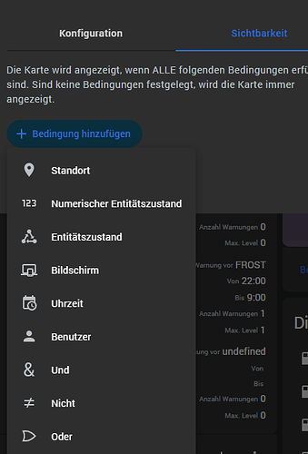

Anyway. As said. There is OR in the visibility options.
Last one here in my German list.
With usage of those:

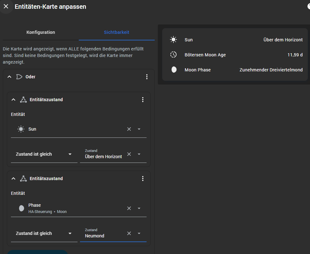

This is then that way in yam (not 1:1 to screenshot above, another example for screenshot):
type: entities
entities:
  - entity: sun.sun
  - entity: sensor.moon_age
  - entity: sensor.moon_phase
visibility:
  - condition: or
    conditions:
      - condition: state
        state: full_moon
      - condition: state
        state: last_quarter
Ahh ok. Das hab ich irgendwie total ignoriert/nicht gesehen. Danke für die Screens und das yaml.
