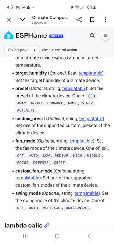

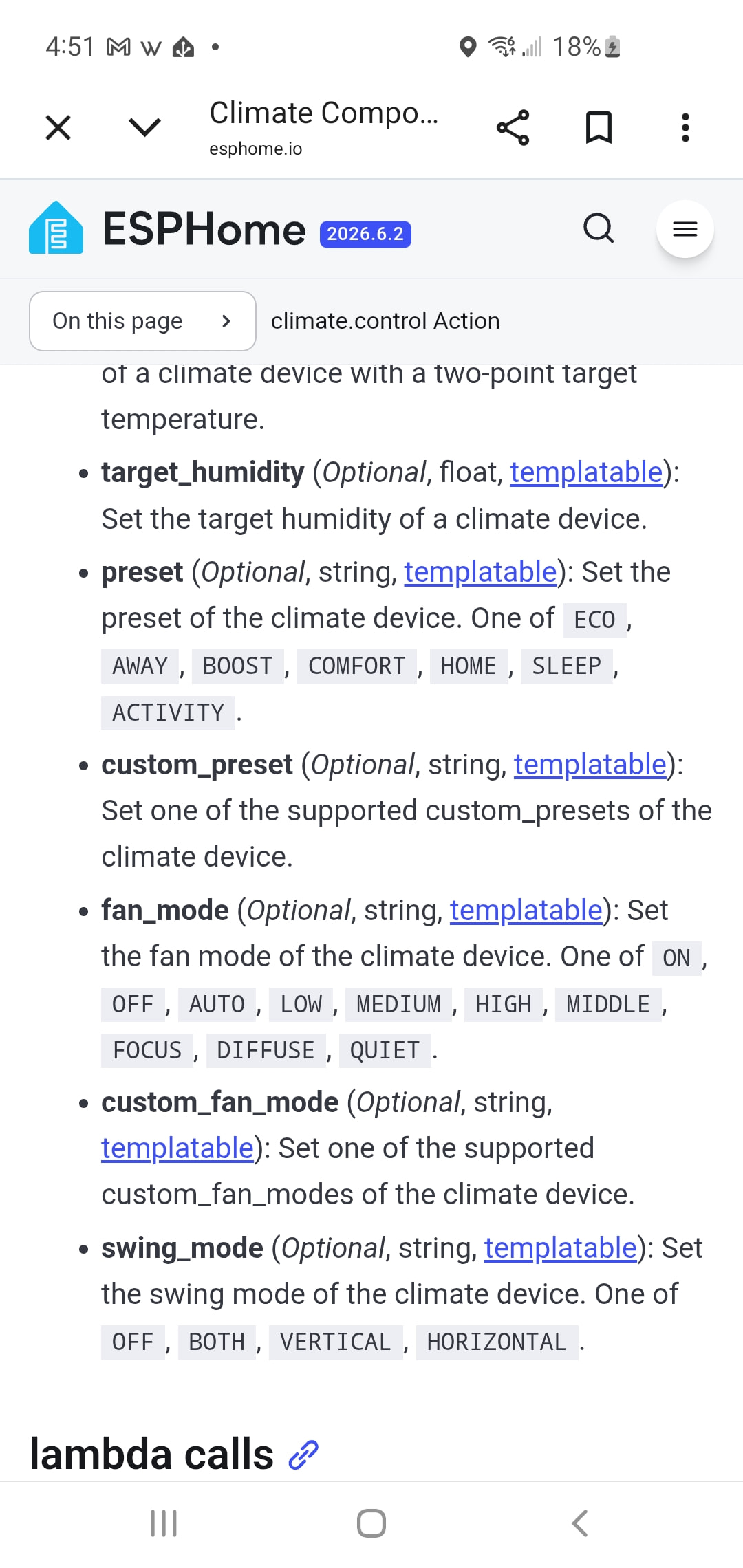

Did you try reading through the Esphome documentation???
Esphome Climate
Somewhere within your Esphome code/config you should see an array of your fan modes listed and whatever order they appear in your code, that's most likely the exact same order that they appear in as default like you're seeing currently. Try editing that list from first/last the way you want it to appear and see if that does the trick.
