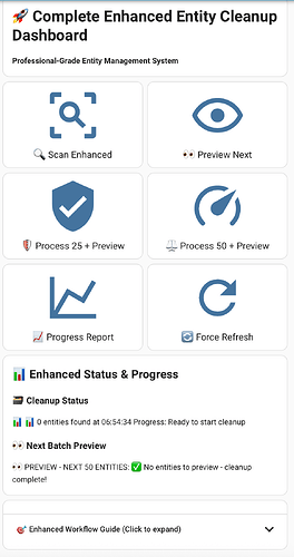

I’m still pretty new to Home Assistant scripting, but I was getting really tired of manually cleaning up orphaned entities (somehow ended up with 1,746 of them! :sweat_smile:).
With some help from Claude AI, I managed to put together a dashboard and scripts that make the cleanup process much less tedious. Thought I’d share in case anyone else is in the same boat!
What it does:
  • Batch processing (25 or 50 entities at a time) instead of one-by-one
  • Preview what will be deleted before actually removing anything
  • Progress tracking so you know how much work is left

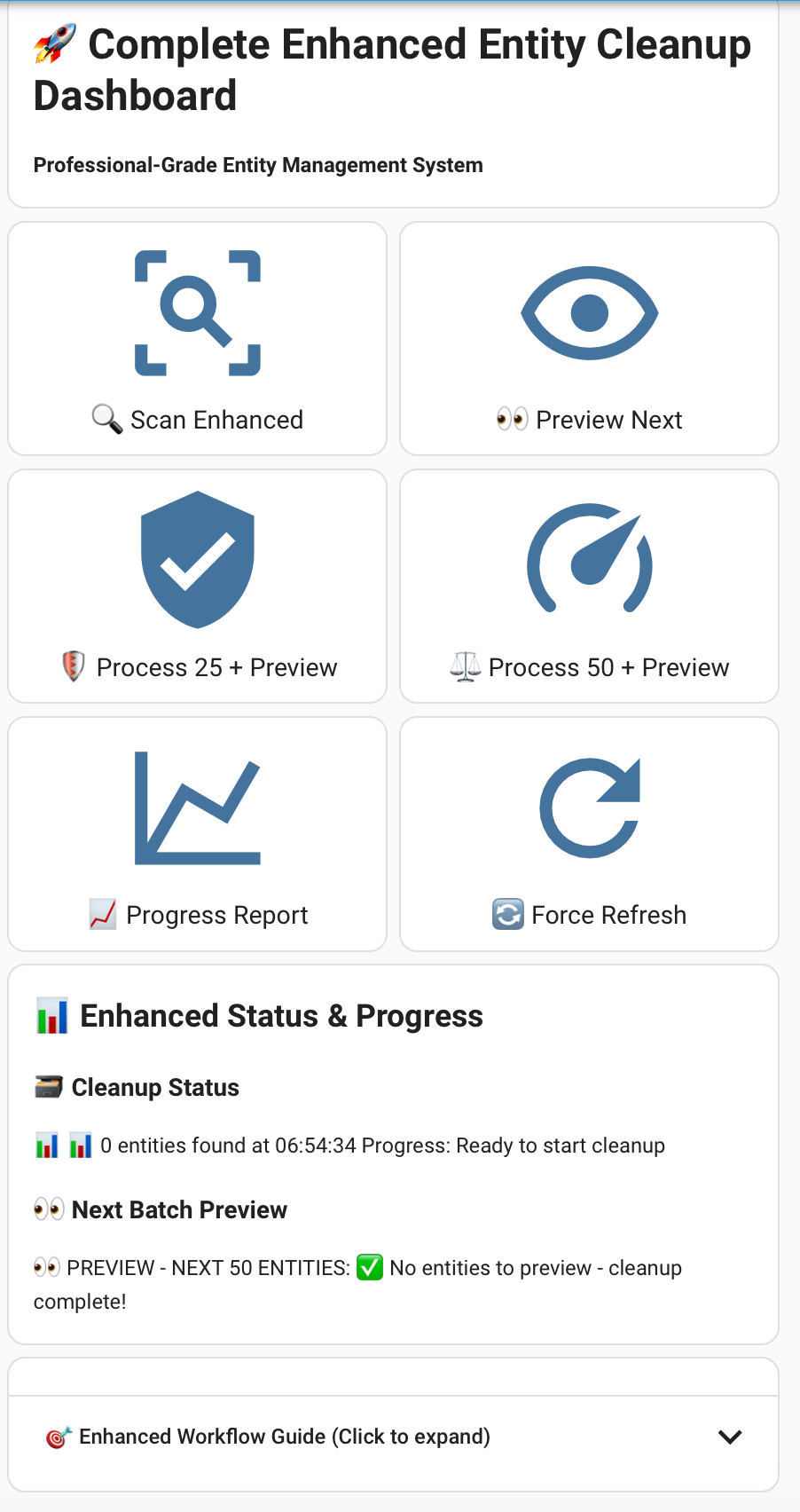

  • Simple dashboard with buttons for each step
How I use it:
  1. :mag: Scan Enhanced - See what orphaned entities exist
  2. :eyes: Preview Next - Review the next batch safely (no changes made)
  3. :shield: Process 25 + Preview - Safe batch processing with auto-preview
  4. :chart_with_upwards_trend: Progress Report - Monitor cleanup progress
  5. :arrows_counterclockwise: Force Refresh - Sync dashboard if needed
Nothing revolutionary, but it beats clicking through hundreds of individual entities!

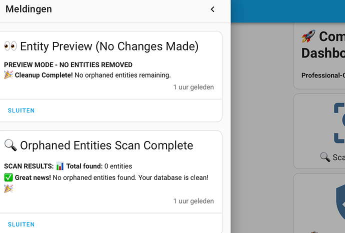

Screenshots:
![Dashboard Screenshot]
The preview feature was super helpful - caught a few entities I actually wanted to keep.

Results:
Successfully cleaned up my 1,746+ orphaned entities with this system. The batch processing made it manageable, and the preview prevented any mistakes.
