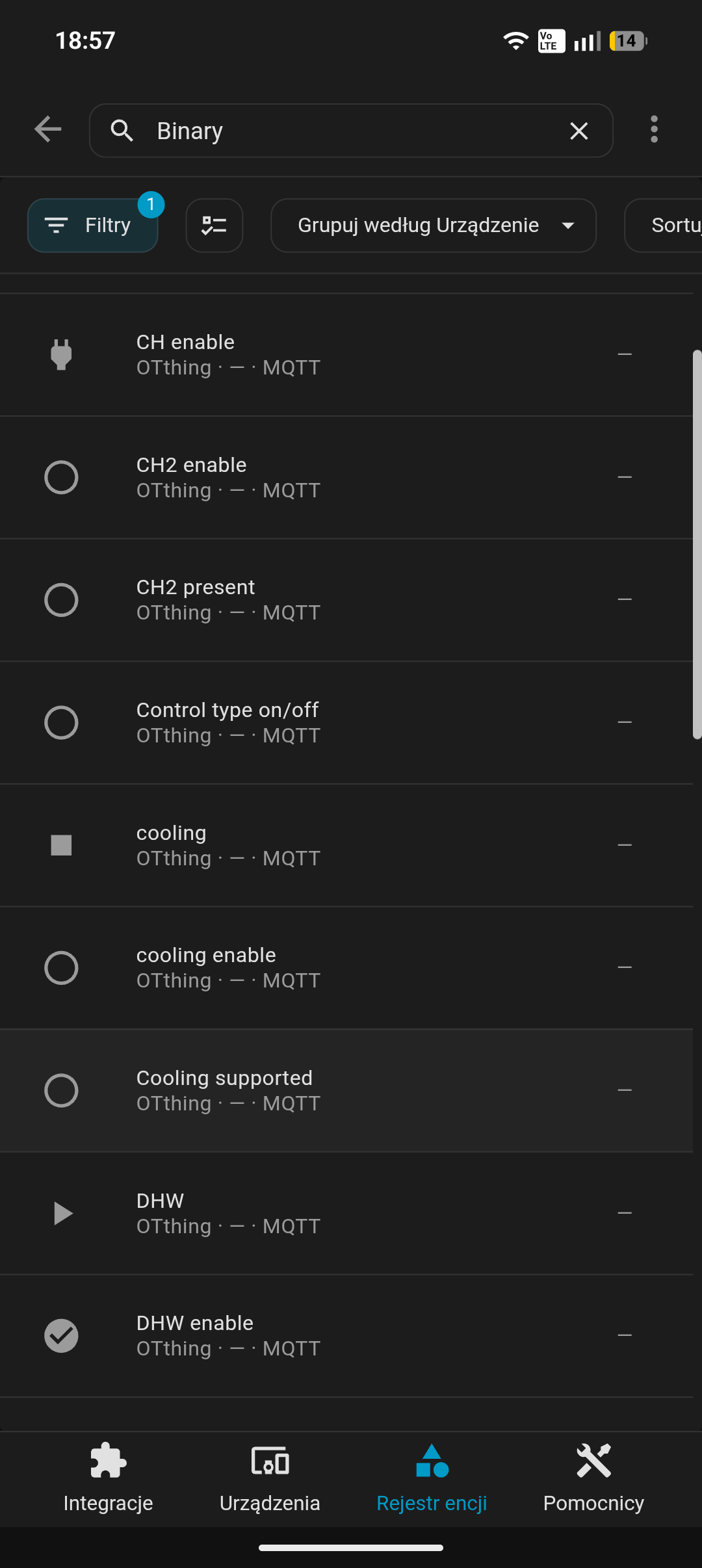

After manually updating the firmware to 2.35, it seems to have resolved the issue again. :slight_smile: I have another question: after connecting to the digital input, what is it called in Home Assistant? I have several binary sensors and I don’t know which one is for the digital input. Which one should be used? Which one is the digital input? I can check by unplugging it and checking which one is gone, but I don’t have access to the furnace right now.
OK, I think it was enough to connect on/off to the digital input and your controller gives this command to the furnace and turns on the heating?
The digital input was not yet implemented, please see
Digital input can be configured under setup, then a sensor appears in HA.

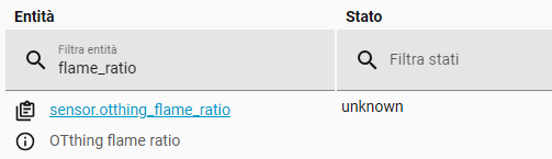

With the latest version v2.38 flame rate is no longer sent to HA via MQTT
status
{"runtime":42135,"freeHeap":70356,"largestBlock":51188,"resetInfo":12,"fw_version":"2.38","USB_connected":false,"reset_reason0":12,"numWifiDisc":0,"dateTime":"24.03.2026 08:18:07","wifi":{"status":3,"mode":1,"ipsta":"192.168.1.9","mac":"08:92:72:CF:A1:B8","hostname":"otthing","sta_ssid":"FASTWEB-VIHV4D","rssi":-60},"mqtt":{"connected":true,"basetopic":"otthing/CFA1B8","numDisc":1},"slave":{"slave_config_member":{"value":"410b","dhw_present":true,"ctrl_type":false,"cooling_config":false,"dhw_config":false,"master_lowoff_pumpctrl":false,"ch2_present":false,"memberId":11},"slave_ot_version":"3.0","slave_prod_version":"23.1","status":{"value":"200","fault":false,"ch_mode":false,"dhw_mode":false,"flame":false,"cooling":false,"diagnostic":false},"vent_status":null,"max_cap_min_mod":{"max_capacity":19,"min_modulation":27},"dhw_bounds":{"max":65,"min":40},"ch_bounds":{"max":54,"min":0},"rel_mod":0,"ch_pressure":1,"flow_t":46.2,"return_t":45.9,"unsuccessful_burner_starts":1,"num_flame_signal_low":0,"oem_diag_code":0,"burner_starts":25232,"ch_pump_starts":20022,"dhw_pump_starts":2080,"dhw_burner_starts":19507,"burner_op_hours":803,"chpump_op_hours":1488,"dhwpump_op_hours":19295,"dhw_burner_op_hours":110,"fault_flags":{"value":"ff","service_request":false,"lockout_reset":false,"low_water_pressure":false,"gas_flame_fault":false,"air_pressure_fault":false,"water_over_temp":false,"oem_fault_code":255},"rp_flags":{"value":"303","dhw_setpoint_rw":true,"max_ch_setpoint_rw":true,"dhw_setpoint_trans":true,"max_ch_setpoint_trans":true},"boiler_fan":{"setpoint":0,"actual":0},"flame_current":0,"connected":true,"txCount":84232,"rxCount":84152,"timeouts":0,"flameStats":{"duty":0,"freq":0.7,"onTime":0.4,"offTime":63.4}},"thermostat":{"ch_set_t":41.7,"room_t":15.1,"room_set_t":15,"master_prod_version":"1.0","max_rel_mod":80,"master_ot_version":"4.2","master_config_member":{"value":"108","smartPowerImplemented":true,"memberId":8},"dhw_set_t":47,"status":{"value":"200","ch_enable":false,"dhw_enable":true,"cooling_enable":false,"otc_active":false},"outside_t":2.5,"max_set_t":60,"txCount":173171,"rxCount":173171,"invalidCount":1,"smartPower":"low"},"heatercircuit":[{"roomsetpoint":15,"roomTempFilt":15.10841418,"roomtemp":15.1,"ovrdFlow":false,"mode":2,"integState":0,"flowMin":20,"suspended":true},{"roomsetpoint":21,"roomTempFilt":0,"ovrdFlow":false,"mode":2,"integState":0,"flowMin":20}],"bypass":false,"outsideTemp":2.6,"1wire":{},"BLE":{},"aux1":{},"aux2":{}}
config
{"slaveApp":0,"otMode":1,"enableSlave":true,"boiler":{"dhwOn":true,"dhwTemperature":47,"overrideDhw":false,"coolOn":false,"otc":false,"summerMode":false,"dhwBlocking":false,"maxModulation":80},"heating":[{"flow":45,"roomtempcomp":0,"chOn":true,"flowMax":60,"exponent":1.5,"gradient":1.05,"offset":7,"marker":[],"roomsetpoint":{"source":0,"temp":17},"roomtemp":{"source":0},"overrideFlow":false,"roomComp":{"enabled":true,"p":2,"i":0.5,"boost":2},"enableHyst":true,"hysteresis":0.1},{"flow":30,"roomtempcomp":0,"chOn":false,"flowMax":60,"exponent":1.3,"gradient":1.4,"offset":0,"marker":[],"roomsetpoint":{"source":0,"temp":21},"roomtemp":{"source":1},"overrideFlow":false,"roomComp":{"enabled":false},"enableHyst":false}],"vent":{"ventEnable":false,"openBypass":false,"autoBypass":false,"freeVentEnable":false,"setpoint":3},"outsideTemp":{"source":0,"apikey":"undefined","lat":null,"lon":null,"interval":null},"mqtt":{"host":"192.168.1.16","port":1883,"user":"ale","pass":"ca501","tls":false,"keepAlive":15},"masterMemberId":8,"hostname":"otthing","haPrefix":"homeassistant","haName":"OTthing","timezone":3600}
otitems
{"slave":{"slave_config_member":{"id":3,"enabled":true,"lastMsgType":4,"numSet":1,"value":"410b","disc":true},"slave_ot_version":{"id":125,"enabled":true,"lastMsgType":4,"numSet":1,"value":"300","disc":true},"slave_prod_version":{"id":127,"enabled":true,"lastMsgType":4,"numSet":1,"value":"1701","disc":true},"status":{"id":0,"enabled":true,"lastMsgType":4,"numSet":50876,"value":"200","disc":true},"vent_status":{"id":70,"enabled":true,"lastMsgType":3,"numSet":0},"max_cap_min_mod":{"id":15,"enabled":true,"lastMsgType":4,"numSet":1,"value":"131b","disc":true},"dhw_bounds":{"id":48,"enabled":true,"lastMsgType":4,"numSet":1,"value":"4128","disc":true},"ch_bounds":{"id":49,"enabled":true,"lastMsgType":4,"numSet":1,"value":"3600","disc":true},"tr_override":{"id":9,"enabled":false,"lastMsgType":7,"numSet":1},"rel_mod":{"id":17,"enabled":true,"lastMsgType":4,"numSet":4212,"value":"0","disc":true},"ch_pressure":{"id":18,"enabled":true,"lastMsgType":4,"numSet":1406,"value":"100","disc":true},"dhw_flow_rate":{"id":19,"enabled":false,"lastMsgType":7,"numSet":1},"flow_t":{"id":25,"enabled":true,"lastMsgType":4,"numSet":4211,"value":"2df3","disc":true},"flow_t2":{"id":31,"enabled":false,"lastMsgType":7,"numSet":1},"dhw_t":{"id":26,"enabled":false,"lastMsgType":6,"numSet":1},"dhw_t2":{"id":32,"enabled":false,"lastMsgType":7,"numSet":1},"outside_t":{"id":27,"enabled":false,"lastMsgType":7,"numSet":704},"return_t":{"id":28,"enabled":true,"lastMsgType":4,"numSet":4211,"value":"2db3","disc":true},"exhaust_t":{"id":33,"enabled":false,"lastMsgType":6,"numSet":1},"tr_override2":{"id":39,"enabled":false,"lastMsgType":7,"numSet":1},"vent_ot_version":{"id":75,"enabled":false,"lastMsgType":7,"numSet":1},"vent_prod_version":{"id":76,"enabled":false,"lastMsgType":7,"numSet":1},"rel_vent":{"id":77,"enabled":false,"lastMsgType":7,"numSet":1},"rel_hum_exhaust":{"id":78,"enabled":false,"lastMsgType":7,"numSet":1},"co2_exhaust":{"id":79,"enabled":false,"lastMsgType":7,"numSet":1},"supply_inlet_t":{"id":80,"enabled":false,"lastMsgType":7,"numSet":1},"supply_outlet_t":{"id":81,"enabled":false,"lastMsgType":7,"numSet":1},"exhaust_inlet_t":{"id":82,"enabled":false,"lastMsgType":7,"numSet":1},"exhaust_outlet_t":{"id":83,"enabled":false,"lastMsgType":7,"numSet":1},"exhaust_fan_speed":{"id":84,"enabled":false,"lastMsgType":7,"numSet":1},"supply_fan_speed":{"id":85,"enabled":false,"lastMsgType":7,"numSet":1},"power_cycles":{"id":97,"enabled":false,"lastMsgType":7,"numSet":1},"unsuccessful_burner_starts":{"id":113,"enabled":true,"lastMsgType":4,"numSet":703,"value":"1","disc":true},"num_flame_signal_low":{"id":114,"enabled":true,"lastMsgType":4,"numSet":703,"value":"0","disc":true},"oem_diag_code":{"id":115,"enabled":true,"lastMsgType":4,"numSet":703,"value":"0","disc":true},"burner_starts":{"id":116,"enabled":true,"lastMsgType":4,"numSet":703,"value":"6290","disc":true},"ch_pump_starts":{"id":117,"enabled":true,"lastMsgType":4,"numSet":703,"value":"4e36","disc":true},"dhw_pump_starts":{"id":118,"enabled":true,"lastMsgType":4,"numSet":704,"value":"820","disc":true},"dhw_burner_starts":{"id":119,"enabled":true,"lastMsgType":4,"numSet":704,"value":"4c33","disc":true},"burner_op_hours":{"id":120,"enabled":true,"lastMsgType":4,"numSet":141,"value":"323","disc":true},"chpump_op_hours":{"id":121,"enabled":true,"lastMsgType":4,"numSet":140,"value":"5d0","disc":true},"dhwpump_op_hours":{"id":122,"enabled":true,"lastMsgType":4,"numSet":141,"value":"4b5f","disc":true},"dhw_burner_op_hours":{"id":123,"enabled":true,"lastMsgType":4,"numSet":140,"value":"6e","disc":true},"fault_flags":{"id":5,"enabled":true,"lastMsgType":4,"numSet":1406,"value":"ff","disc":true},"rp_flags":{"id":6,"enabled":true,"lastMsgType":4,"numSet":1,"value":"303","disc":true},"remote_override_function":{"id":100,"enabled":false,"lastMsgType":7,"numSet":1},"vent_fault_flags":{"id":72,"enabled":false,"lastMsgType":7,"numSet":1},"boiler_heat_ex_t":{"id":34,"enabled":false,"lastMsgType":7,"numSet":1},"boiler_fan":{"id":35,"enabled":true,"lastMsgType":4,"numSet":1406,"value":"0","disc":true},"flame_current":{"id":36,"enabled":true,"lastMsgType":4,"numSet":1406,"value":"0","disc":true},"brand":{"id":93,"enabled":false,"lastMsgType":7,"numSet":1},"brand_version":{"id":94,"enabled":false,"lastMsgType":7,"numSet":1},"brand_serial":{"id":95,"enabled":false,"lastMsgType":7,"numSet":1},"num_tsps":{"id":10,"enabled":false,"lastMsgType":7,"numSet":1},"size_fhb":{"id":12,"enabled":false,"lastMsgType":7,"numSet":1}},"master":{"ch_set_t":{"id":1,"enabled":true,"lastMsgType":1,"numSet":5033,"value":"2979","disc":true},"ch_set_t2":{"id":8,"enabled":false,"lastMsgType":3,"numSet":0},"room_t":{"id":24,"enabled":true,"lastMsgType":1,"numSet":704,"value":"f19","disc":false},"room_t2":{"id":37,"enabled":false,"lastMsgType":3,"numSet":0},"room_set_t":{"id":16,"enabled":true,"lastMsgType":1,"numSet":704,"value":"f00","disc":false},"room_set_t2":{"id":23,"enabled":false,"lastMsgType":3,"numSet":0},"master_prod_version":{"id":126,"enabled":true,"lastMsgType":1,"numSet":235,"value":"100","disc":true},"max_rel_mod":{"id":14,"enabled":true,"lastMsgType":1,"numSet":235,"value":"5000","disc":false},"master_ot_version":{"id":124,"enabled":true,"lastMsgType":1,"numSet":235,"value":"402","disc":true},"master_config_member":{"id":2,"enabled":true,"lastMsgType":1,"numSet":235,"value":"108","disc":true},"dhw_set_t":{"id":56,"enabled":true,"lastMsgType":1,"numSet":1406,"value":"2f00","disc":false},"status":{"id":0,"enabled":true,"lastMsgType":1,"numSet":50956,"value":"200","disc":true},"vent_status":{"id":70,"enabled":false,"lastMsgType":3,"numSet":0},"day_time":{"id":20,"enabled":false,"lastMsgType":3,"numSet":0},"date":{"id":21,"enabled":false,"lastMsgType":3,"numSet":0},"year":{"id":22,"enabled":false,"lastMsgType":3,"numSet":0},"rel_vent_set":{"id":71,"enabled":false,"lastMsgType":3,"numSet":0},"outside_t":{"id":27,"enabled":true,"lastMsgType":1,"numSet":704,"value":"2b3","disc":false},"max_set_t":{"id":57,"enabled":true,"lastMsgType":1,"numSet":235,"value":"3c00","disc":false}}}

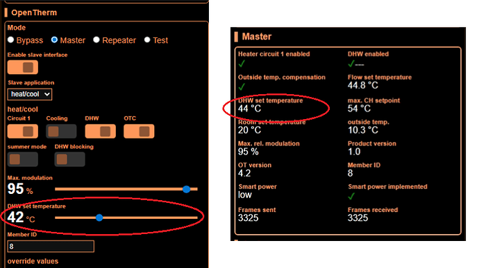

I purchased the Open-Therm interface and have been testing it for a couple of days.
There are some things that aren’t entirely clear to me and that I’d like to explore further.
My heating system consists of a BAXI LUNA IN PLUS 26 boiler controlled by the RC 06.20 climate controller.
My goal is to have all the boiler parameters reported on HA.
The correct configuration seems to be:
  • Mode Master with slave interface enabled.
  • Heat/cool Circuit1, DHW and OTC enabled (i use an external zigbee sensor).
    With this configuration override options ​​(flow temp an DHW) don’t make sense and so I can keep them disabled, correct?
Using the OTthing configuration interface I can correctly set the values ​​of Min and Max flow temperature, default values (if no esternal temp provided) and the heating curve (values ​​are reported in the status section of the web interface).
However, I can’t set the water temperature (DHW) correctly.
If I change the value in the setup section of the configuration interface, the value isn’t reported in the status section.
I’ve also noticed that the entities displayed on HA don’t always match the values ​​set on the device’s web interface. For example, if I change (enable or disable) the Override CH and Override DHW on the web interface (regardless of the selected mode), the settings aren’t reflected on HA (Override entities), and vice versa.
It also happened (occasionally) that by changing some temperature threshold settings via the web interface and saving the values, the climate entities reported on HA for DWH or heating changed status to OFF (randomly) interrupting the boiler operation.
I also noticed that in heating mode, the flame is correctly controlled by the interface but the heating water circulation pump is always on, to turn it off I have to turn OFF the HA climate flow-temperature entity (previously it was in AUTO mode).
Are there any settings I can change to improve my system’s performance?
