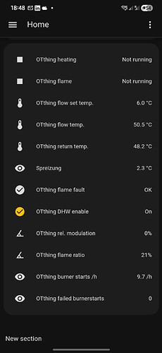

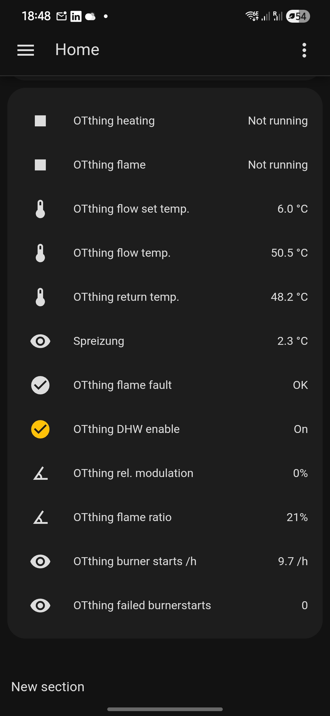

After several tests, I have come to the conclusion that the master/slave mode, although correct, makes the operation of the boiler unpredictable (at least in my case).
The repeater mode with the overrides set to false does not interfere with the normal operation of the boiler but does not return all the operating values of the boiler (supply temperature, return temperature, circuit pressure, etc.).
So in my case, for the purpose for which I had purchased the device (monitoring the boiler’s parameters), the device is useless.
I am currently running in pure repeater mode and everything is reported to HA.

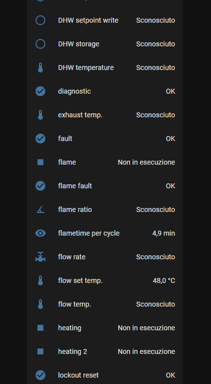

Same settings, pure repeater mode with override values set to false.
Many parameters are not reported in this mode:
This is clear. If the roomunit does not ask for a value, OTthing can’t display it. You were writing about unpredictable behaviour in master/slave mode. What is it about?
Could be the case that only the flowtemperature is overriden, not the on/off bit. I will check.
This is correct. I’ve noticed that if I open the parameters view page from the room unit, parameters are reported statically (they don’t change over time, and the value displayed is the one at the time of reading).

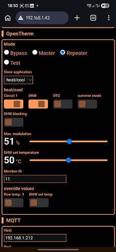

What I need is for the OTThing interface to compensate only the flow temperature based on the external temperature (OTC), leaving all the rest of the control to the room unit and the boiler (the boiler has no external temperature sensor connected).
Should work with repeatermode and setting overflow temp option.
So do I need to enable OTC without any override (as in the picture) or do I need to activate the override for CH1 flow only?
the OTC switch does not do anything in your case, switch on the override CH1 flow switch and OTthing should change the flowtemperature of the boiler according to the heatingcurve everytime your thermostat sends a set flow message.

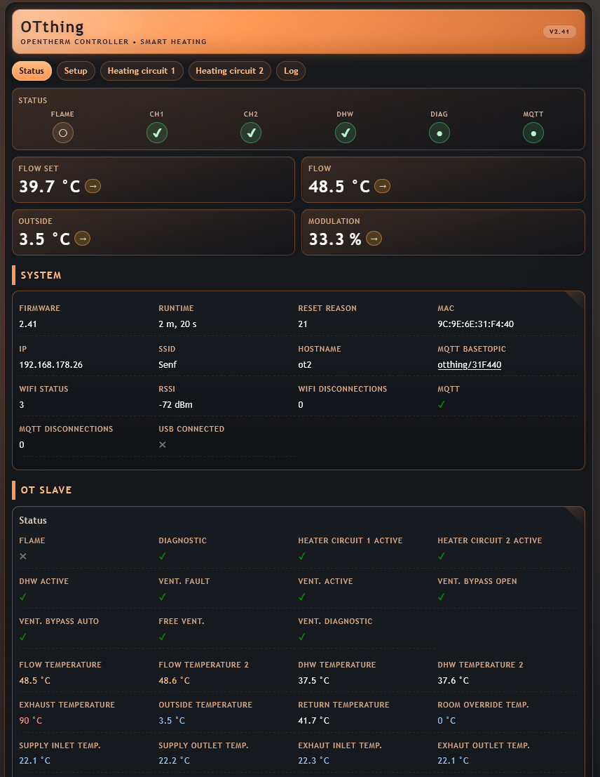

Firmware v2.41 is released. It fixes some minor issues and updates UI:
I love the new interface! Thanks!
By the way, there is one breaking change for me coming from 2.38 and using Repeater mode: I need to enable the new flag “CH On” in overridden values alongside with old and already enabled “CH1 flow”.
