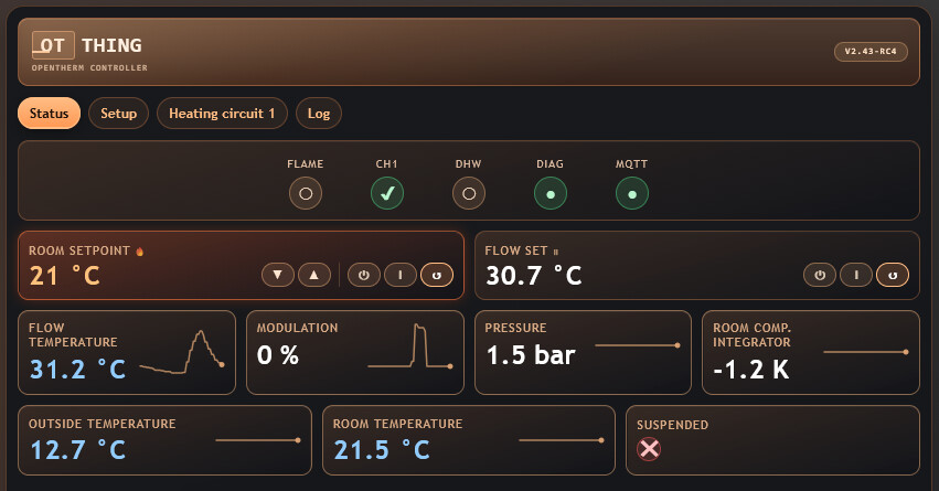

Thanks for the config. Could not yet find it. Can you send me the status JSON of the moment when the problem appears?
Noted, I’ll try upgrading again and send the status.json file if/when it appears again.
I wonder though if it’s not the same issue as Boiler still on · Issue #15 · Phunkafizer/OT-Thing · GitHub because it may also have started to appear when I lowered the setpoint from 16° to 13°C.
I did a test but I was not able to reproduce: Lower roomsetpoint below roomtemperature. Channel 1 went into suspend. Increasing outside temp until flow setpoint goes beliw min. flow temp. Channel 1 kept suspended.
