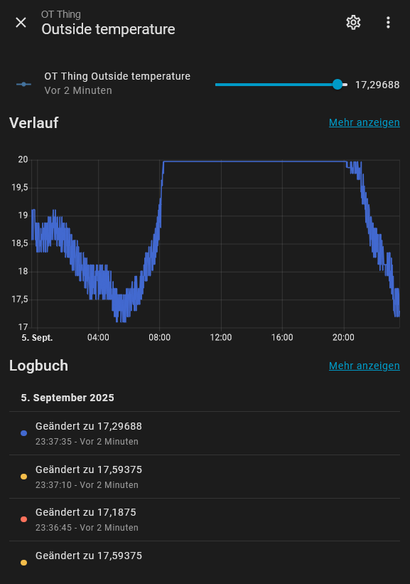

I get the Outside temperature from the boiler but the range ends on 20° in HA:
I would like to get the full range, how can I do it?
Hi! Seems your boiler does not provide the temperature above 20°. You can have a look to the log page of the ot thing and search for the outside temp frames to see what your boiler provides for real.
Regards
Stefan

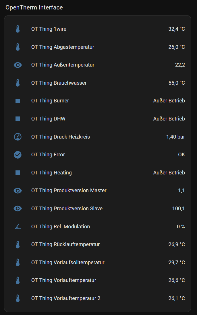

the OT Thing webinterface shows the outside temp (boiler) above 20° but HA did it just up to 20 (this was in FW v2.2).
Now I have FW 2.3 up and running and can see the 1-Wire sensor (DS18B20) in HA but I lost the outside temp (boiler) completely in HA, do you have any Infos abt that?
The outside temperature control in HA is for setting the outside temperature via MQTT when your boiler does not have that sensor. If your outside temperature source in OT Thing is NOT configured to MQTT this control will disappear in HA.
But I added autodiscovery to the value reported from the boiler, see firmware v2.4.

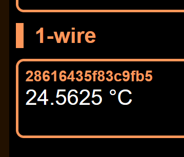

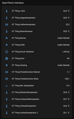

Great, FW 2.4 looks good, thank you for that! I for now have to test more 1-wire sensors on the bus, later on the Interface itself…

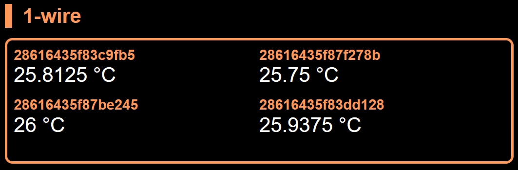

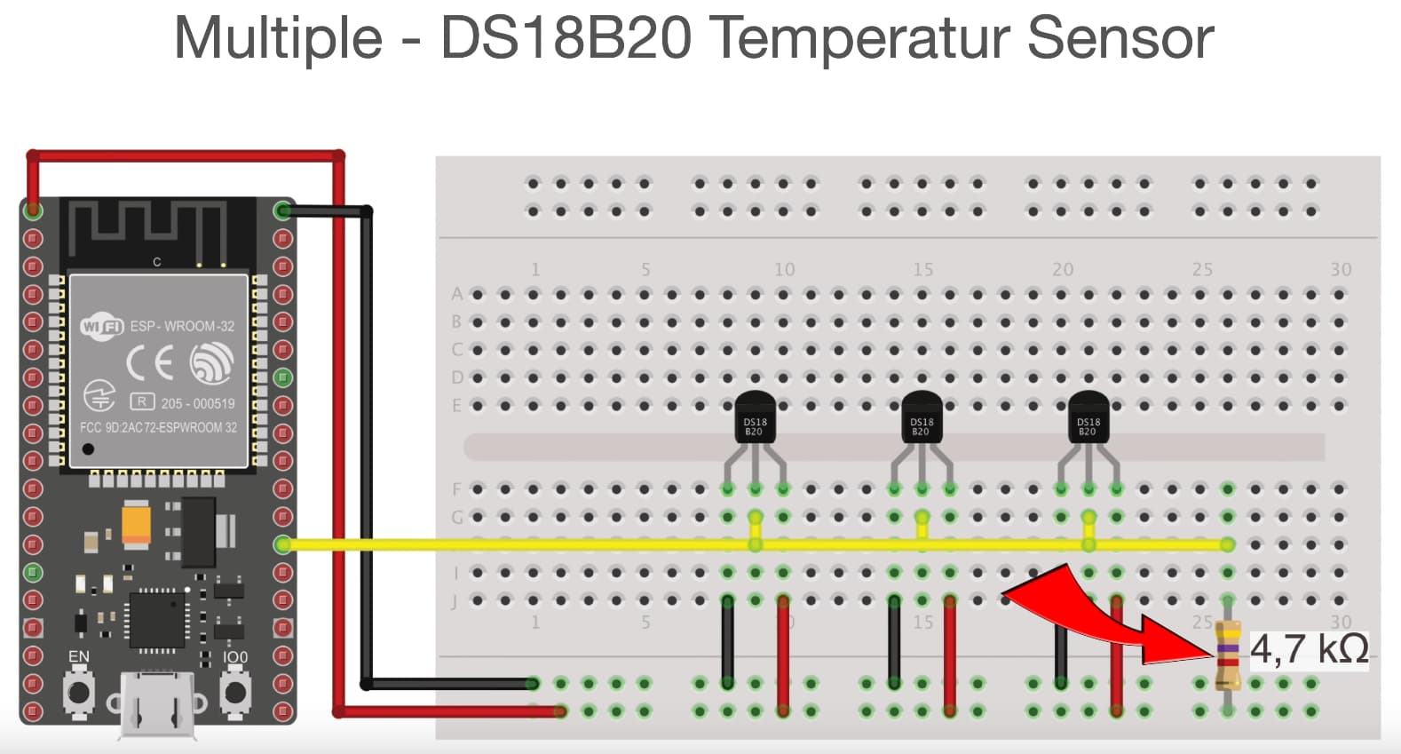

I can get only one 1-wire sensor at the same time on the Interface and under HA.
I think I need another wiring-layout?

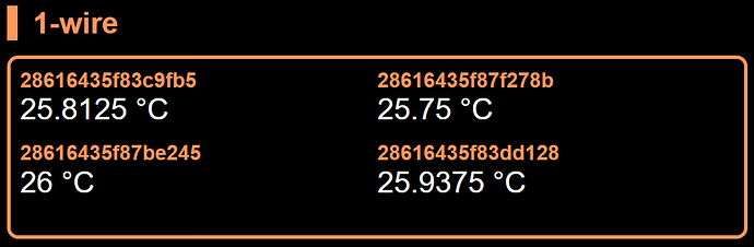

You can connect multiple sensors in parallel. From firmware side it works:
grafik
Maybe there is an error on your wiring.

It works, thank you for your help!

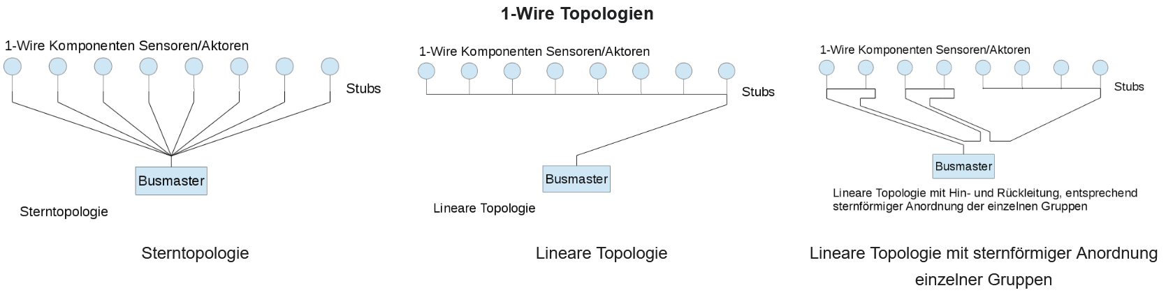

Which topology, for the 1-wire bus, would you suggest?

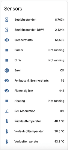

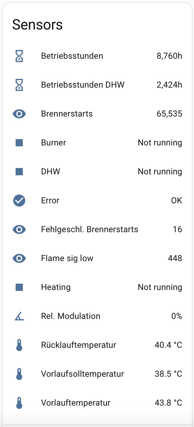

Having my first look at it now, I have noticed the following with version 2.5 firmware that the MQTT sensors when viewed in HA are a mix of German and English.
I can see here that you have updated the values on your Github, I have not searched in your code to see where this is then used.
Thanks for making a great device, I am looking forward to learning what it can do and getting it setup in HA.
I release firmware v2.6. Translations should be fixed.
