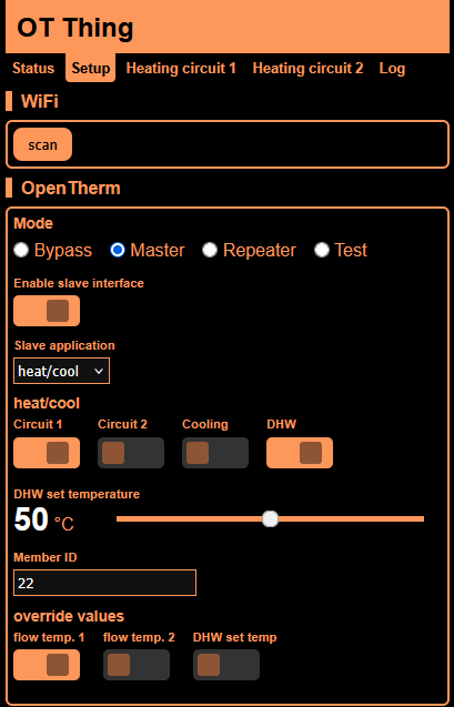

I’ll hold off on ordering for now and let you explore the implementation. Once you’ve had a chance to test and confirm that the setup works reliably — with OT Thing acting as master to the boiler while also adopting the heating setpoint from Wiser via its slave interface and injecting a fixed DHW temperature — I’d be happy to purchase and help test it.
Also, thanks for confirming that the relay would automatically fall back to connecting Wiser directly to the boiler if OT Thing loses power — that’s reassuring and exactly what I was hoping for.

It seems to work. You will have to configure OT Thing like so:
