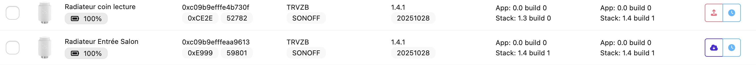

I just bought a whole bunch of Sonoff TRVZB and after pairing them, I’ve been notified that a firmware update was available. So I did what apparently I shouldn’t have done : I started to update them all at the same time.
Most of them succeeded but for some, it seems they’re stuck somehow. I still see them as “updatable” but when I click on the button, I get a “(No image currently available)” error.
However, they seem to be in the right version.
I clicked on the “skip version” on the main HA settings but in Z2M, I still see the button to upgrade. Is there something to do there ?
I have one of those. I think it happened when I told more that one to update at the same time and something got all jumbly.
6 monthly software updates later, it’s still there. I try to update and push all the buttons, then push ignore and see it again after the next version update.
If someone has a fix that would be awesome.
I had 2 plugs with the same, showing they needed updating after i had updated several itms at same time.
I ended up deleting them and then add them back and the need for update nolonger shows it needs done and when checking find theat they had already been updated
This has been solved “automatically” with the installation of the last Z2M update.
