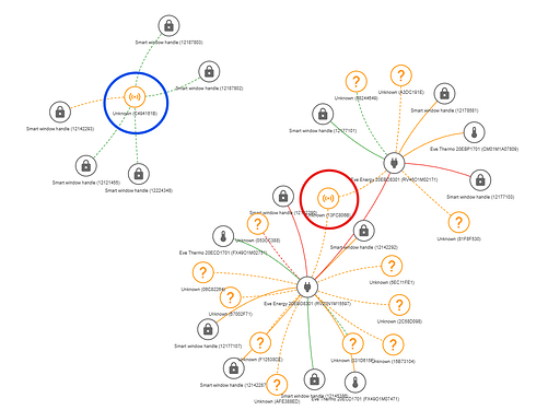

However, the Thread Network Mesh under the Matter UI has changed. This is what I had before:
And this is what I see after updating. The two plugs are no longer connected the initial ZBT1 border router (blue circle) but to a new one (red circle), which didn’t exist before. OTBR still shows HA as the same and only border router in my system.
Nothing has changed other than running the update. Independently of this I had ordered two additional Eve plugs. Now curious to see how they will fit into the mesh.
P.S.: The question marks are probably left overs in the Eve plugs’ internal Thread tables. I’ve read that Eve is notorious for not completely resetting the tables and that devices require two resets before they are fully clean again.
I wouldn’t worry about it too much since everything is working. Give it a day or 2 and look at the map again. It does take a bit of time sometime to see an accurate map after any change to the mesh.

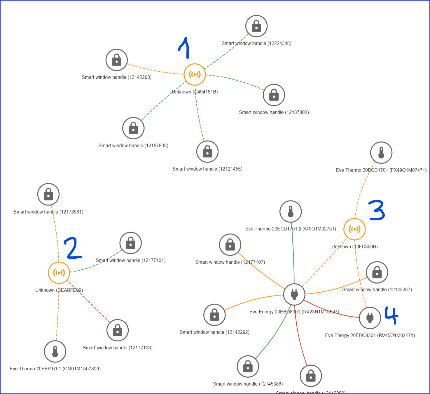

I was able to get rid of the annoying unknown devices in my mesh. Following up on my working hypothesis that the “?” were left-overs in the plug’s internal reference table, I performed a factory-reset one the plug with the three “?” and re-paired with HA. The new device got registered under its previous name, thus doubling all its entities. This was cleared with a restart of HA. Interestingly this removed only one of the three "?.
The final solution was actually much simpler. It is sufficient to disconnect the Eve plugs for one minute, plug them back in and then reload the OBTR integration. My mesh is now much clearer.
A few points aren’t yet what they should be:
  1. is my ZBT-1. Does the USB stick always display as external hence unknown border router?
  2. is an Eve plug that should display as such but is represented as another border router. I can control devices on this node from HA, but the mesh shows them as unconnected.
  3. is yet another border router, however, physically the same as 4
All these points are merely cosmetic.

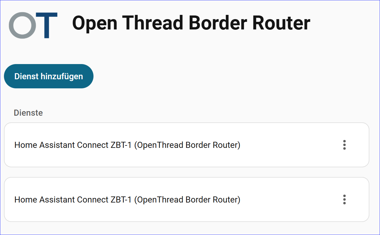

I wanted to give Thread 1.4 a chance and updated my ZBT-1 to the latest beta 2.7.2.0. The OTBR integration is now showing to services for the ZBT-1:
I restarted HA (HAOS in a VM) and OTBR but not the RPi5 itself. The two entries remain. Any idea how to remove the duplicate entry?
I then switched on the Beta in OTBR. The ZBT-1 still shows as “Router (external)”. In exchange I got 8+4 “?” again. I guess that these come from the “old” ZBT-1 service.
EDIT:
I uninstalled the OTBR app, rebooted and reinstalled. While this removed he duplicate entry, it led to losing the OTBR preferred network. I was unable to redefine it and decided to roll back my proxmox image. So for the moment I live with the double entry.
Possibly this bug: Detected that integration ‘otbr’ creates a config entry when another entry with the same unique ID exists · Issue #142313 · home-assistant/core
