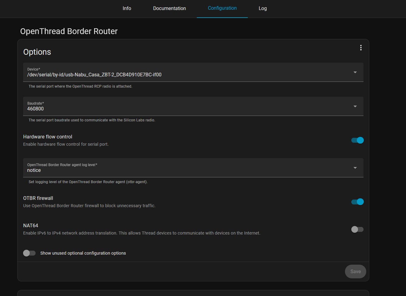

OTBR cooked. Failed to perform next registration:
Upgrading to ZBT-2 led to my OTBR add on unaliving itself.
Issue remains after multiple reboots and even reverting to previous backup.
Looking at the logs here are some of the main errors I receive.

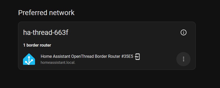

This is not an issue… AFAIK DUA is a Thread feature that deals with multiple Thread networks under the concept of a single domain which is not applicable here. I have this error in my setups too but OTBR still works.
You are of course getting a lot of drops, but they appear to be from the same device.
Maybe some of the errors are non issues but I still can’t connect to any new or old thread devices… Tried just about everything including reaching out to NabuCasa. Can’t figure it out…
