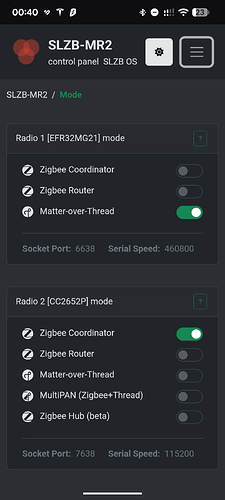

I have checked the setup on the web interface and it is as below
But your error text says port 6638 and your configuration picture says 7638
Config shows it is using port 6638 for Thread/EFR32MG21, so not sure why its not accepting connections from HA. I have seen other types of devices not letting go of the ports when disconnected, so maybe try a power down/up of the MR2 and see if that does anything.
Out of curiosity, is ZigBee working for port 7638?

Yes ZigBee is fine. I will try power cycling it again when I get home. I have some matter wall switches and relay and they seem to be working fine which I don’t understand They are all Sonofff so I’m not sure if they are actually using the Ewelink protocol.
