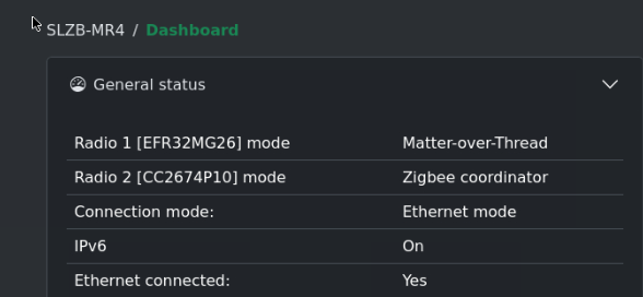

I had the same issue, Reflash the EFR32MG26 chip in the SLZB-MR4 and everything will work again.
Hi, with the new firmware 3.10 all is working

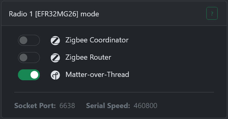

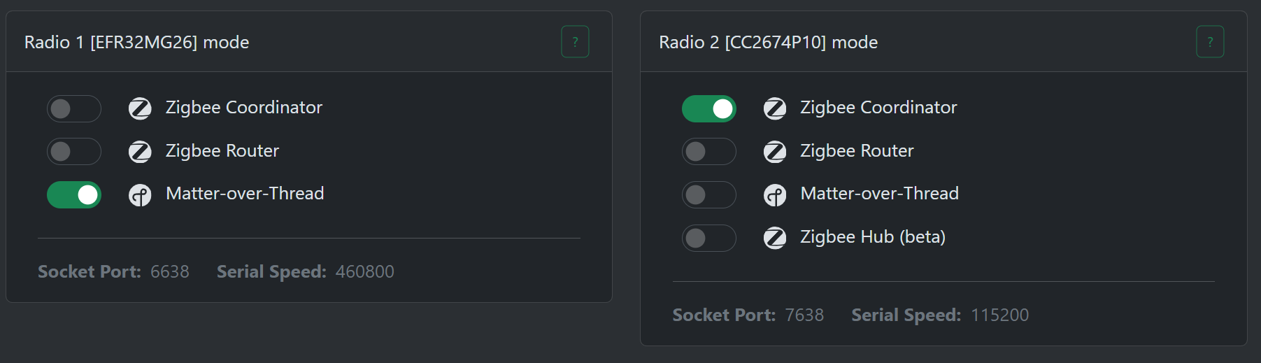

Which radio are you using for Zigbee vs Thread? Their website has a recommended config.
I am indeed using the MG26.
But I also tried the P10 - with the very same results.

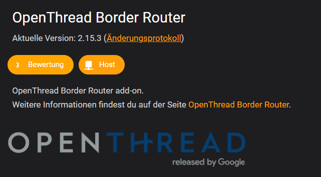

For me this setup works. MR4U is connected via LAN. I use HA 2026.1.x
I have 40+ Zigbee devices but only a few IKEA matter devices.
With this MoT Firmware:
OTBR Version 2.15.3
OTBR Config
baudrate: "460800"
flow_control: false
otbr_log_level: notice
firewall: false
nat64: false
network_device: 192.168.1.79:6638

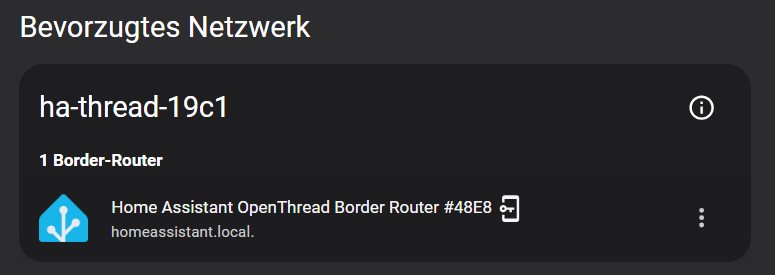

The Thread integration shows this:
Last Important Step → Synchronize Thread Credentials:
In HA Android App: Setup → Companion App → Troubleshooting → Sync Thread Credentials
For me this now works with IKEA Matter devices and is stable. In parallel I run Zigbee on the same MR4U without any issues.

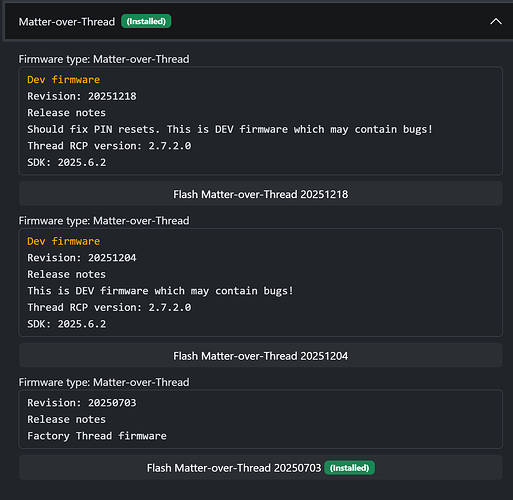

About 10 days ago I got an updated firmware from SMLight (which is now the dev version 20251218) - and that one works for me.
I had a single incident 3 days ago where I lost my 2 bilresa buttons and had to newly pair them. But I hope that this was just a temporary glitch.
