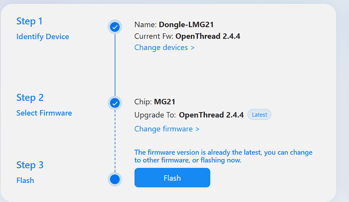

Today i receive my Sonoff lmg21 dongle.
I flashed it with sonoff dongle flasher:

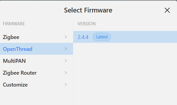

I already asked chatgpt and it says " **OTBR tries to talk to the RCP but doenst get a response, This confirms **the dongle is not speaking the Spinel RCP protocol
Your Sonoff Dongle Lite MG21 is not running an RCP firmware. The version you flashed (OpenThread 2.4.4) is NCP-style firmware, not RCP.

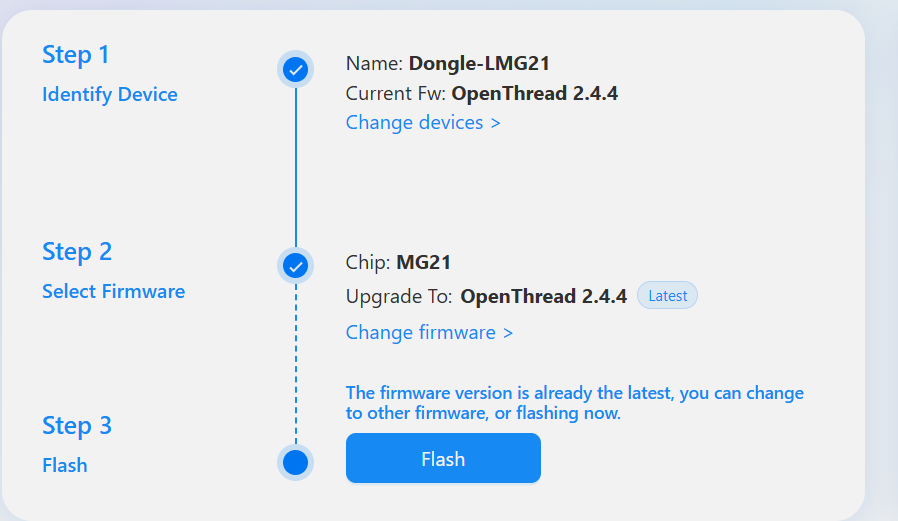

But i only have this option in the flashing tool, i am not able to choose NCP or RCP:
Does anyone know how i can fix this?
