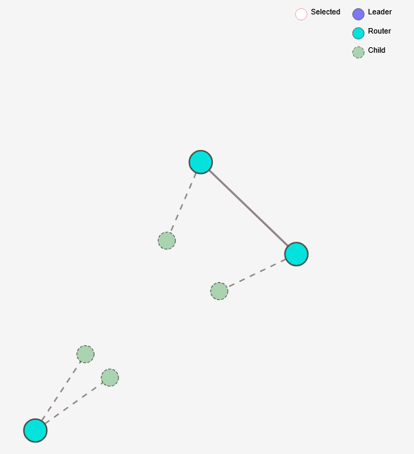

I got the new 3.0.0 OTBR version today. Now instead of a partial map I get nothing at all. Well, there's a spinning circle of green/blue/red/yellow, but that's it.
I tried with and without beta enabled and after restarting Home Assistant in both modes. The only thing I didn't do was a full system reboot.
Actually, I kept testing as I typed and eventually got the diagram below after turning off the beta (again) and restarting HA. I have never had that kind of disjoint map before. I have only one border router and one network name. Everything is connecting fine. It's just that if there is a topology map it should work :).
The map is auto-reloading occasionally now. The number and type of nodes varies a bit, but it continues to be disjoint.
I had the same blank-topology thing after a core update and it turned out my OTBR add-on kept switching back to disabled logs. Flipping debug on, then fully restarting the whole host instead of just the add-on brought the map back. Also worth peeking at Settings - System - Repairs because mine quietly showed a border router integration error that didn’t pop up anywhere else.
