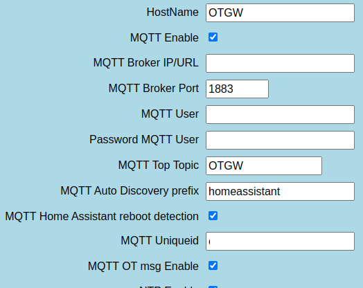

I managed to set the outside temperature by using the OTGW in MQTT mode and dropped the official OTGW integration. I’m using the latest firmware version from rvdbreemen on my OTGW. I’m currently on v0.10.3+e334c42
OTGW settings:
Make sure:
  • to setup a MQTT broker on the device where you’re running HA. I use Mosquitto as the broker.
  • to enable the MQTT integration in HA.
  • to add the ‘MQTT Auto Discovery prefix’ value to: homeassistant (this will make the device to appear in HA automagically, including the most important sensors. Please note that not all sensors are available in MQTT mode, but this is not an issue for me personally.
  • to set a value the ‘MQTT Uniqueid’ field.
  • that you don’t use MQTT on the OTGW alongside of the official integration, because the can cause unpredictable results.
